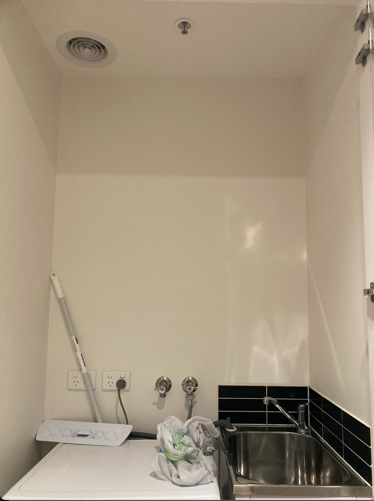

I have a European laundry (a laundry in a cupboard space basically) but it has no shelving at all.
I am interested in buying some shelves to place above the washing machine and just wanted to check what you'd recommend, in terms of wood type etc - I do not want cupboards - just shelving. The width is 106 cm.

Hello @EricL thanks so much for your reply!
The width of the area is 106 cm and I've popped a picture in below ![]()
Thank you for the tip regarding the Specrite panels I had no idea you had to do this! I think the melamine panels might also be an option due to moisture in the area.

Hello @cvh3196
Thank you very much for posting that picture of your laundry and telling us the size of the area. I propose using Practa 2200 x 600 x 26mm Acacia Timber Benchtop or similar for your shelves in the laundry area. I've placed an image below to give you an idea of what it might look like when installed. I also suggest getting some Everhang 30-40mm Broom Holder - 2 Pack for your mop handles.
Please remember to seal your timber panels on all sides before you install them in your laundry area.

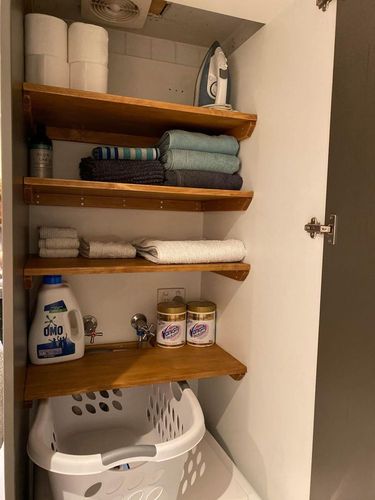

Hey @cvh3196, and thanks for the tag @Akanksha -
I built some shelves for a very similar space a few years back.
I used pine utility panels for mine:
