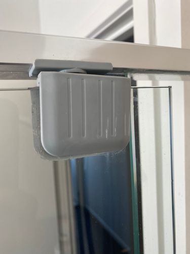

Alignment hinge

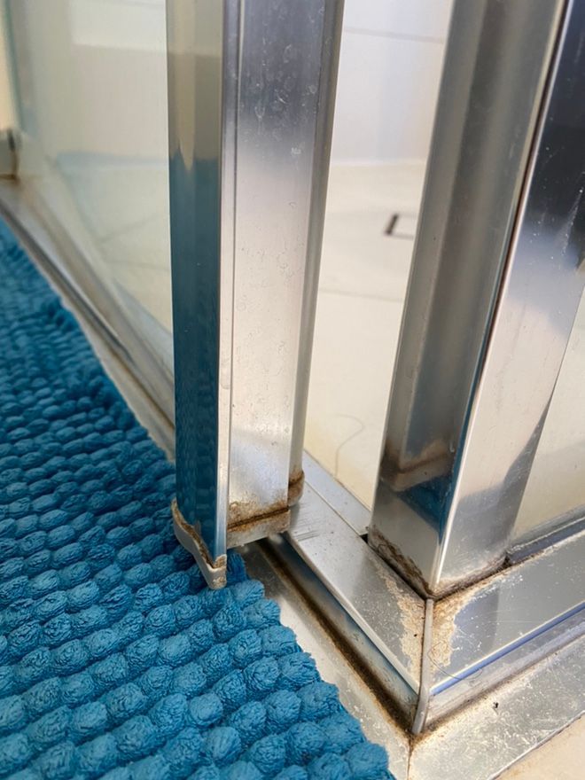

Door scrapes the bottom

Removing the plastic cover reveals a screw which is to control the alignment of the door on a channel. It does not allow for the glass to be released in this design, it looks like.
I tried with adjusting this to either end, and while it resolved the issue of the door scraping the bottom, the top part of the door still scrapes the top and wont close. I can see the part from where it looks like the glass has seemingly moved from its original position, so not sure if these adjustments will help in this case.
Any other suggestions for me to try?

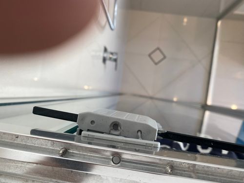

@EricL I had tried the adjustments on the lower hinge too, with no luck.
Looking top-down onto the door, this looks to be the issue. The glass is held by the clamp using glue perhaps, which has given way causing the misalignment. Looks like no adjustment of the screw will resolve this. ☹️
You can see the glue remnants on the right of the clamp.

Does anybody know the manufacturer of this hardware. I have the exact same and the bottom pin has snapped and looking for a replacement.
Thanks
