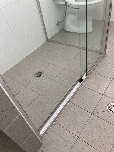

How do I adjust the shower door which catches on the bottom aluminium frame
Welcome to the Bunnings Workshop community @penritchard. It's wonderful to have you join us, and many thanks for your question about adjusting a shower screen door.
Is it the whole width of the door that scrapes or just the far corner from the hinges, as marked below? If it's predominantly the corner, it's likely the top hinge that has slipped out of position and needs to be adjusted, or it is damaged. The adjustability of your hinges depends on the door design. It might just be a case of loosening the hinge, re-aligning the door and re-tightening the hinge.
Due to the fact that glass shower doors and panels are highly susceptible to shattering, it would be my advice to enlist the services of a professional to complete the adjustment. Someone familiar with shower screen installations should be able to make the adjustment for you.
