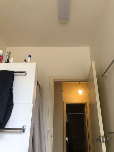

Can you take some photos of the bathroom area including the shower so we can see how all that relates to window and wall.

Hi @Stephy
Because there is no way to get the exhaust air out through the ceiling, a combo unit isn't suitable for this job. So taking into account that both windows are capable of being opened it will have to be a wall mounted fan. The good thing is that there is already an air brick style vent in close proximity to the current conduit run to the light. You should check if there is a corresponding vent brick in the external wall and if so, it could well be possible to mount a fan in that location. and connect it to the same feed as the light.
You will need an Electrician for this work though!.
