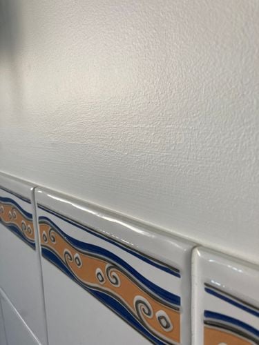

I would like to add a tongue and groove feature wall to the top section in the bathroom above the existing tiles. I am going to paint out the features in the tiles. My question is how to attach 9mm VJ board and finish it up against the thickness of the existing tiles. Or would you suggest using another product?

Placing the Easycraft EasyVJ Panel right next to the tile is possible. However, I recommend adding a border to the top of the tile to break up the transition from your tile to the EasyVJ Panel. The timber piece does not have to be very big, its purpose is to provide a border between the tile and the EasyVJ Panel. It will allow you to hide the difference between the height of the tile and the EasyVJ Panel.
Buying a sample sheet at the store will allow you to place the EasyVJ Panel right next to the tile. This will show you how much of a difference there is in thickness.

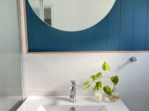

I like to breakup the tile and VJ panelling with a piece of timber.
In my bathroom post we were taking on earlier, I use the timber benchtop to cut a piece. It had to be cut down anyway, so worked perfectly and it tied it all together.
For the other bathroom Reno (I’m yet to share), I used a square piece of Tasmanian oak….
