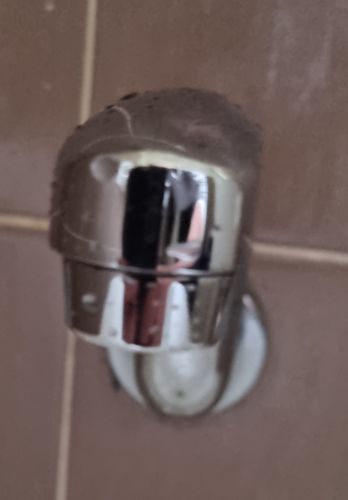

Hello,

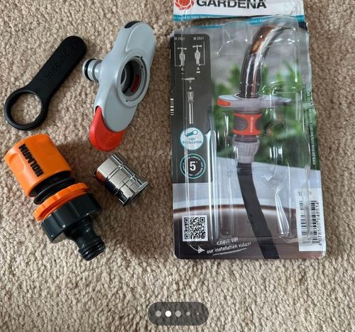

I want to connect a hose to my bathroom tap to water my plants on the balcony. I've found a gardena Adaptor (see pic). I was wondering if this can work with my current tap (see pics). The gardena says it is compatible with all popular taps with M 24 x 1 male and M 22 x 1 female threads. I cannot figure out what kind of tap I have. Thanks a mil

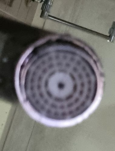

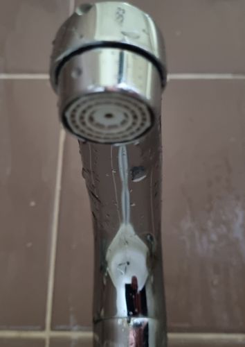

The piece I have circled in the below image is called an aerator. It is similar to this one FIX-A-TAP WELS 5 Star 6L/min Male Swivel Aerator.
You will have to remove this using the provided tap spanner to allow the adaptor to screw into the tap in the same way the aerator has been.

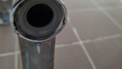

My question is in relation to the gardena adapter. I don't know if it will fit my pipe ( see pic of my pipe). The gardena iInstructions say the adapter is compatible with all taps with M 24 x 1 male and M 22 x 1 female threads. I cannot figure out what kind of tap I have 😞. Thanks for ur help

It appears you have now removed the aerator from your tap, which is great. The next step is to screw on the adaptor, which I've circled in red below. Your tap looks like it has the M 22 x 1 female threads. You might need to remove a portion of the adaptor to reveal the male threaded section you need to screw into the female threads on your tap.
