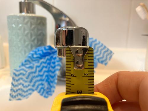

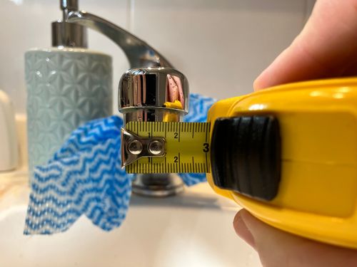

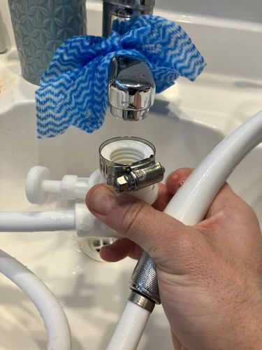

2 - the bathroom sink tap that we are attaching to has a very short lip to attach to, about 7mm. We’ve tried a hose clamp but this doesn’t do the job.
In order to try and hit two birds with one stone, is there any standalone hoses which we could use as an interface between the sink tap and the plug on shower head? I’m guessing it would have to much better match the sink tap form and maybe we will have to use a thinner hose clamp?

It’s a tricky one to overcome. If you were to replace the hose entirely, you’d need a suitable fitting on one end to screw onto the shower head and something on the other end that could securely attach to your sink spout — and I’m not aware of any off-the-shelf hoses that would suit that exact situation.
Likewise, extending the existing hose with extra tubing would be challenging, as finding a compatible adaptor that doesn’t leak or restrict water flow can be difficult.
The push-on spout adaptor you have now is pretty much the only style made for that purpose, and since your current hose isn’t long enough, there’s not much point trying to cobble together a workaround — it would likely be fiddly, unreliable, and end up costing more in parts than it’s worth. We do have the Pope Indoor Tap Adaptor , which the push-on adaptor could potentially connect to; still, you'll have the short hose. If that did work, we have a range of clear vinyl hose. If there happens to be one close to the external size of the current hose, it could be cut and extended with it by heating the ends of the clear hose in hot water and pushing it over the white hose.

7mm tubing likely has a 5mm internal diameter. It would be fine for washing a baby, but I don't think it would give you much flow for a proper shower.
