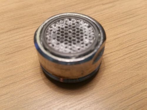

I don't have a dedicated space for a washing machine in my unit, so I would need to hook it up to the kitchen sink as and when I need it. I have been advised that this can be achieved by an adaptor (Like this one) on my kitchen sink tap and the drain pipe also hooked over the kitchen sink.

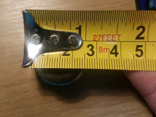

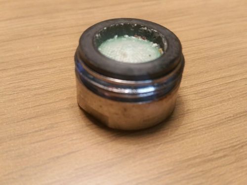

How do I know what size adaptor will fit my tap? I unscrewed the aerator and measured it. Looks to be around 2.5cm. Engraved on the part is "neoperl Perlator HC PCA 7.0l" I found this manufacturer's website but can't really make head nor tail of it!

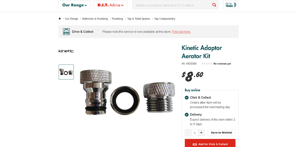

The Team member was adamant that there was no such item for this task (either in Bunnings or otherwise). I have posted my problem in another forum in Australia, where there are plumbers/DIY people and they said there is definitely such a thing. In my OP, there is a link to one actually on Bunnings website. All I wanted to know is if this was the right size for my tap. I hope someone can help me with this.

Below are the parts you will need to connect your washing machine to your sink mixer. The kit is generic but I reckon you have a 90% chance of it fitting in to your existing tap. Good luck and stay safe. Tell us if it works!
Cheers,
Red
The middle ring is the one that goes on first followed by the ring on the right (2nd).The middle ring is the one that goes on first followed by the ring on the right (2nd).Make sure to put plumbers tape on the (2nd ring) before screwing this on to it. You can the put more plumbers tape to this before attaching the washing machine hose.Make sure to put plumbers tape on the (2nd ring) before screwing this on to it. You can the put more plumbers tape to this before attaching the washing machine hose.

I just wanted to add that the product @redracer01 has recommended is the one I would have suggested to you. To the best of my knowledge, this is the most appropriate product in our range to suit your purpose. As redracer01 has mentioned there are a few different thread patterns, but there is a very high chance that this product will fit and solve your issue.
