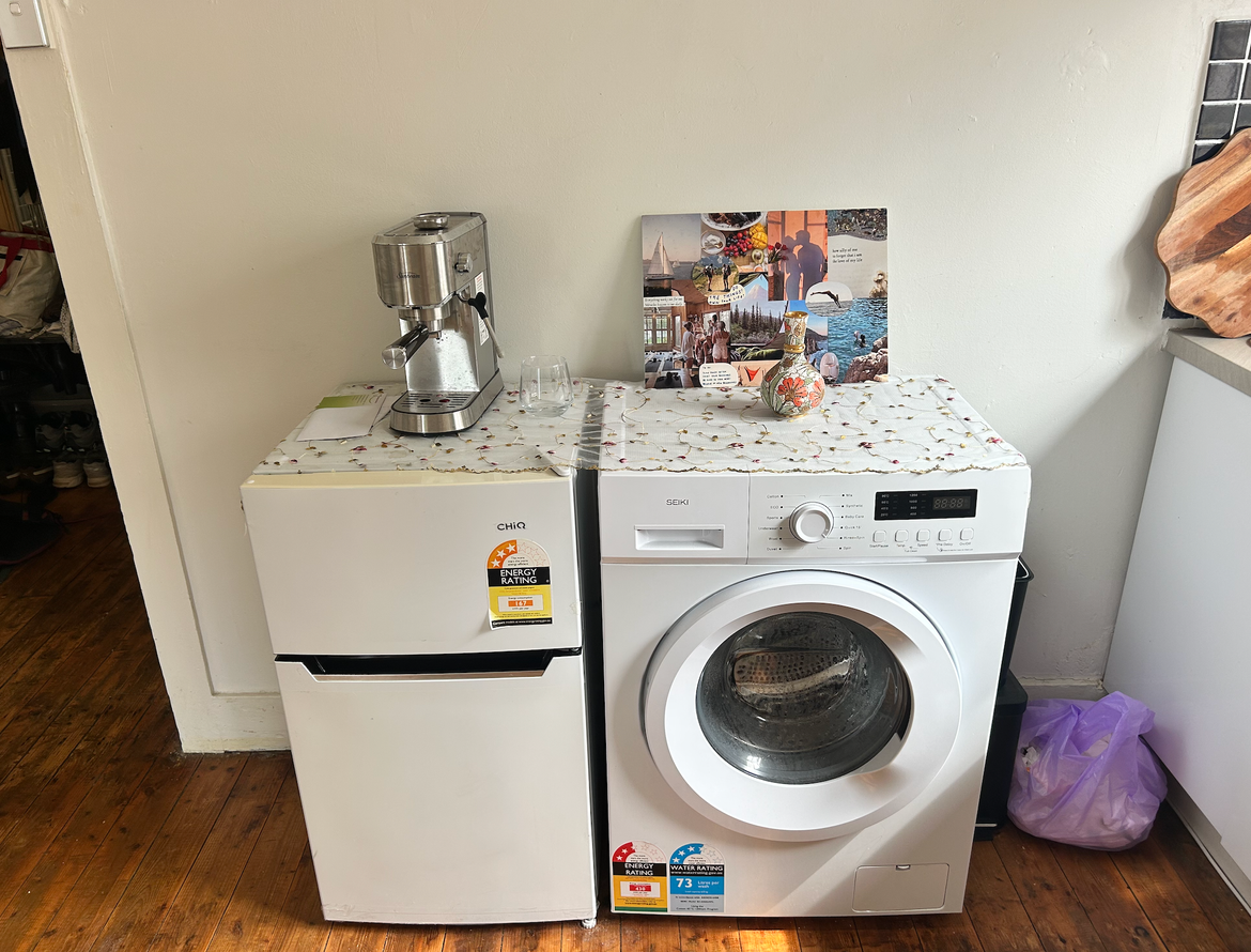

I want to make a DIY wood looking cabinet or something of that sort to hide my fridge & washer in the kitchen & provide me with extra countertop space. Open to any suggestions but I'm thinking a top piece of wood & two side pieces that are attached with some sort of bracket. I don't need a back since it's against the wall and to allow some airflow. A front isn't super necessary unless there's a cheap option, I was thinking of just adding a curtain to hide it from the front.
How would I go about making this / is this even feasible? I have a screwdriver but not electric or fancy. I've never built anything like this before and I'd be doing it alone. Ideally on a budget too. If there are other ideas that I haven't considered, also open to hearing them!
I've attached a photo of the space & the dimensions are:
550 width x 880 height x 1200 length

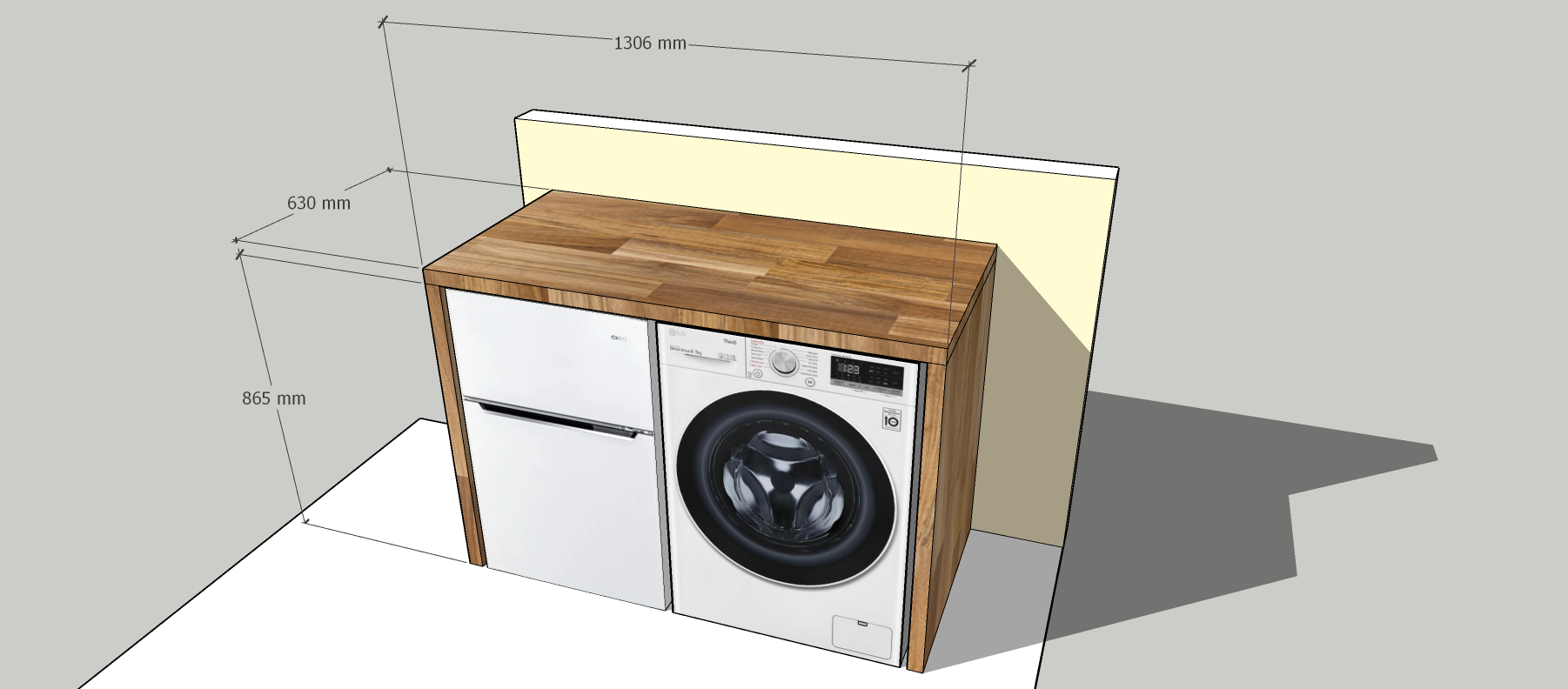

There was a recent question regarding a similar topic, they had a washer and dryer and wanted to cover the machines to make them look nice. The same solution should fit your needs. I suggest using two of the Specrite 2200 x 600 x 26mm Timber Multi Use Pine Panel for the top and legs of the cabinet. I recommend using two Carinya 125 x 100mm Black Heavy Duty Angle Bracket in each corner where the benchtop meet the legs. To keep the brackets in place I suggest using Zenith 8G x 25mm Countersunk Gold Rib Head Chipboard Screws - 40 Pack
To keep the table stable and moving from side-to-side, I suggest attaching Hafele 23 x 23mm Angle Bracket - 20 Pack on the interior of the legs and the floor. You can use the same screws suggested earlier. I've placed an image below to give you an idea of what it could look like. The measurements are for reference only, please adjust them to your needs.
