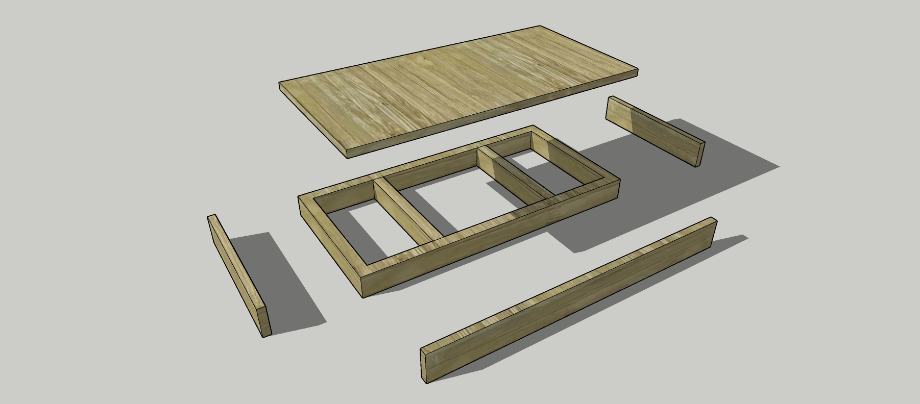

However, if you wish to use a timber slab, I propose speaking to a builder and asking them if they can build a faux timber benchtop vanity. Generally speaking, it could be built using timber framing and a multipurpose panel to give it that timber slab look but without the heavy weight. Plus, it can be tinted to any colour you like. I've placed an image below to give your builder an idea of how it can be built.

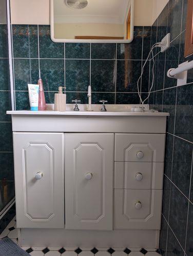

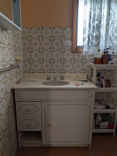

Do you think it's doable looking at my current basin vanity setup?

You can remove your current benchtop—most are either screwed in from underneath with brackets or glued to the vanity carcass. If it’s glued, removal might take a bit more time and care, but it’s still manageable. Once the plumbing has been disconnected by a licensed plumber, you can replace the old benchtop with a timber slab or panel.
Bunnings has a good selection of multi-use timber panels that can be turned into custom benchtops. Just pick a timber that suits the look you’re after—merbau, hardwood, or even acacia are popular choices. It’s important to fully seal the timber before installation to protect it from water damage, especially around the basin area. A clear polyurethane or a dedicated timber benchtop sealer would work well.
For your basin, using a bowl-style one that sits on top of the benchtop (rather than recessed) makes installation much easier. You’ll just need to cut a hole for the waste and potentially another for the tap if it’s not wall-mounted.
