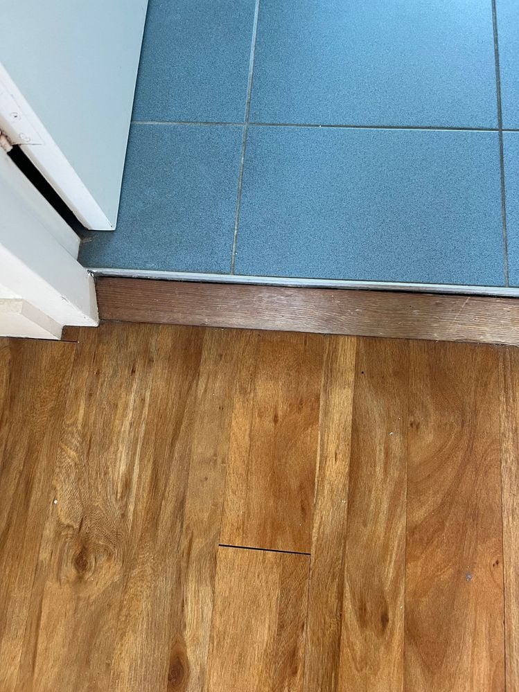

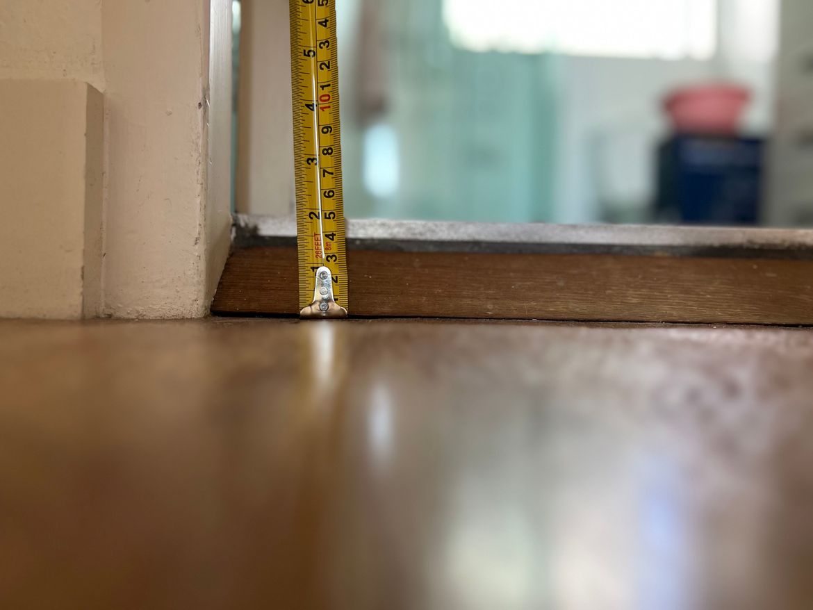

As I am renting the place, I do not have the authority to remove the existing ramp at the threshold. However, the current ramp is too low for my vacuum robot to climb to the bathroom. Unfortunately, normal ramps wouldn't work as they require 90 degree angle in the threshold. I was wondering if there are any alternative solutions or adjustments that can be made in this situation.

I imagine your vacuum robot has got fairly small wheels so the angle of the ramp would need to be reduced dramatically.

By the way, I'm not saying you should replace the threshold trim (I'm not sure it would fix your problem), but considering the 1cm gap between the tiling and the top of the trim, I think you're giving your RE a bit too much credit for their attention to detail ![]()

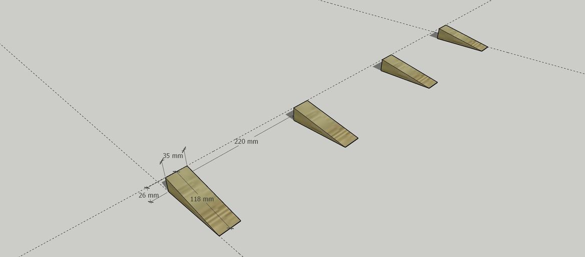

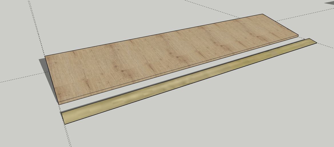

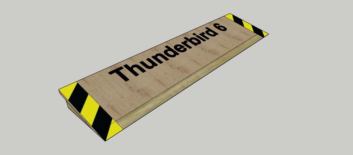

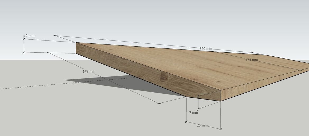

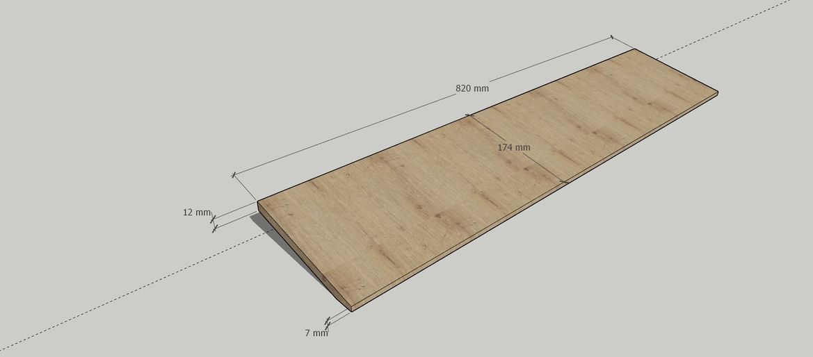

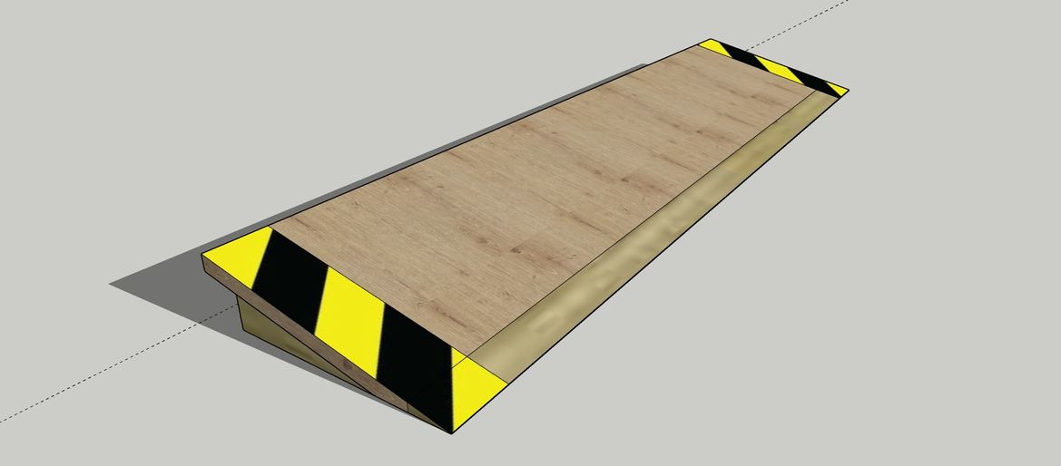

Here are some sample images to give you an idea of how you can put the ramp together. In this iteration I've use 1200 x 1198mm 12mm Plywood Pine Premium BC Grade in combination with the Porta 30 x 12mm 2.4m Tasmanian Oak Bevel Glass Bead. I used the 70 x 35mm Framing MGP10 H2 Blue Pine 5.4m as the wedge support for the bottom of the ramp.
Please note that the measurements are for reference only, please adjust them to your needs.

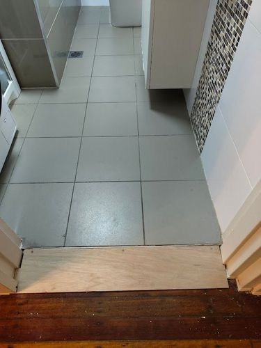

Gotcha, thank you.
I actually wound up going with 1220 x 810mm 4mm Plywood Hardwood Marine AA Grade , because the bracing ply was in an accessible shelf at bunnings, the price was basically the same, and the marine ply was water resistant.
I think its water resistance is plenty sufficient for occasional light water exposure, so I won't add more treatments. I may add some cheap vinyl to the ramp to make it blend in a bit / a bit nicer to step on Winton 305 x 305mm Finger Wood Self Stick Vinyl Tile (but we would step over that threshold anyway).
Overall, I'm pretty happy with the result, wasn't too much work either.
I used the existing trim (it was a rounded trim, 1cm lower than the actual threshold) to brace the ramp, and screwed it directly in.
I used some offcuts from the plywood as "spacers" where I screwed it in, to get the angle right.
I used a jigsaw to cut it to the template so it could be flush with the doorframe.
I accidentally cut off the bottom right part of the template, oops, but also who cares lol.
With an angle trim, it's probably a bit trickier, since I could use the curve of the round trim to set the angle, but overall, it shouldn't be too bad.
Don't overthink it, just send it ![]()
