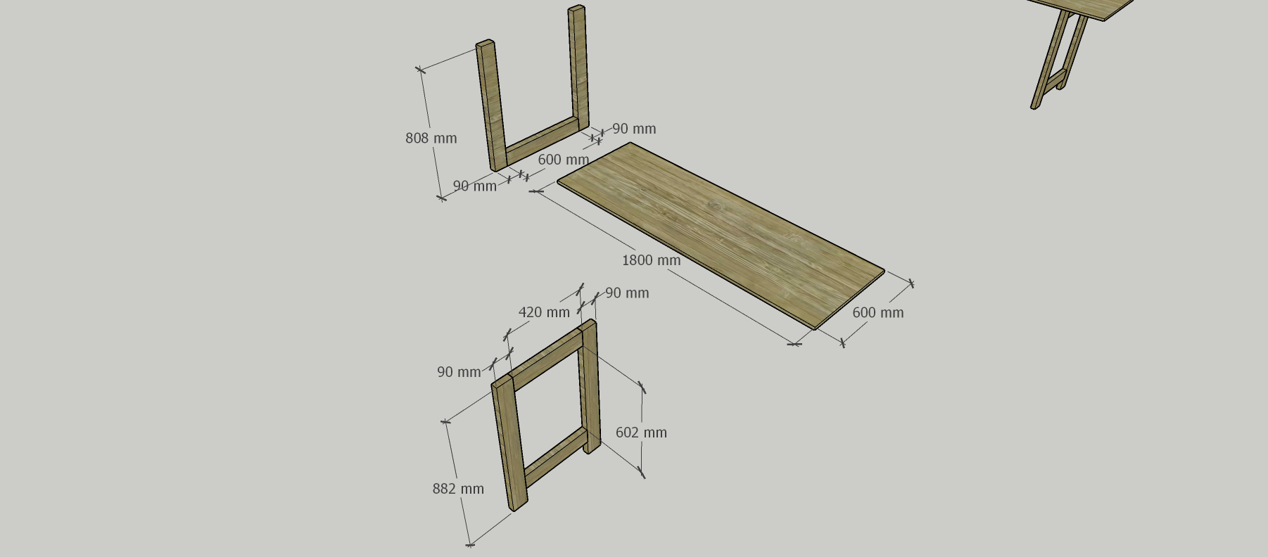

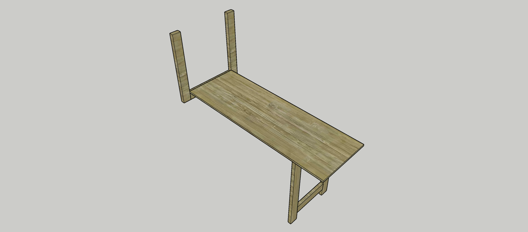

I've drawn up a sample frame work for the fold away wall mounted table.
Here are the list of materials:
The approximate total will be - $273.60 but please leave room for the wall anchors. The measurements are based on the size of the available panel and 710mm is non-standard size and I had to use a 600mm panel. But it is much longer than the 1200mm that you currently have. Please adjust the measurements to your needs.
Let me call on our experienced members @Dave-1, @Nailbag and @AlanM52 for their ideas.

Would it be possible to post a few pictures of the area where you want the table to be? I had pictured it longways to the wall and when I saw @EricL's sketch I went "oops" lol
Having a thought over an alternative to @EricL's
The long side of the table/bench mounted via hinges to the wall (hinges top side of the bench)
A "L" table leg that is hinged so the long side of the L is attached to the bench (allowing it to be folded up), short side hinged to one of the ends of the L so it can folded over onto the long side of the L when storing. (Think picnic bench style)
Two heavy duty chains that are fixed to the wall and to the away from the wall edge to help hold the bench level.
The locking mechanisim I would use the same bolt that @EricL has suggested.
If I had to choose which idea I like I prefer @EricL's design, as I am just offering an alternative.
Hi @Retreat,
Sorry for the rough sketch right hand not happy after replacing heavy duty van battery.
