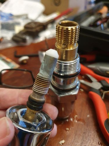

I have this laundry tap and have used your instructions to get the white washer off. However, I don't see how to get the new washer. It's not soft. It's made of very inflexible material and I just don't see how it will go over the cone shape that's much larger than the washer hole.
I've worked out how to get that washer on.
But the leak is coming out of the laundry tap, not the spout, so it hasn't fixed it. I'm unsure which bits to replace and my local bunnings were unable to advise me when I brought the tap in.

Hello @Halimah 🖐I'm afraid I wont be of much use either as I've never dismantled let alone seen one of these taps before, however every leak I have experienced through the body of a tap fixture has been due to a failed o-ring seal on the threaded shaft.
As @DIYGnome has mentioned, water leakage from a handle is typically due to damaged o-rings on the spindle. I'd recommend you change the ones seen in your image as yours look to have some damage.

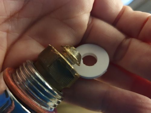

I am trying to work out how to change one of these too. I have a brand new hot tap like this which I want to use on the leaking cold tap. I'm confused as to why the hot tap is longer than the cold one since they are a set, but I still need to replace it. Where can I buy a washer? Although the tap is new, the washer leaks. I need a better one. Thanks.

I had a look at that link. Incorrect for what I need. I need washers not o rings...

We will need to see the washer you want to replace alongside some dimensions to recommend a suitable replacement.
Some photos of the taps that need their washers replaced would also help.

You will have to grab a FIX-A-TAP Assorted Washer Kit. One of the washers in this kit will match and replace your existing washer.
Ummm no they won't. Inthe original post, the lady was having the correct ones left at the counter I believe, and they were a soft one not hard like these. I have terrible times with hard washers. I always need dome washers to stop the dripping. So I'm after the upgraded ones made especially for this brand as they changed them to the softer ones in the batch after mine. Please refer to the original thread to see what I mean. I need those ones. Thanks. 😊
As I linked in the original post, these Kinetic Washing Machine Conversion Kit Washers would be the correct replacement. Since these are brand new taps, I'd suggest speaking with the team in-store about providing the replacement washer free of charge. Please take your proof of purchase for the taps in with you.
