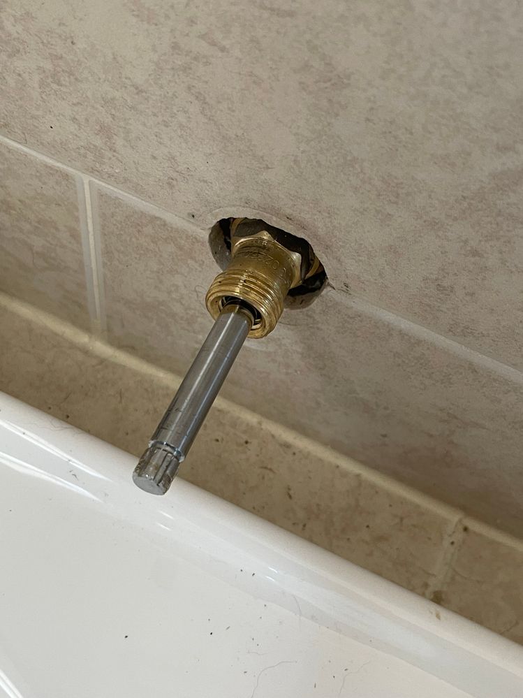

Hello I’m trying to undo this with a spanner but it won’t grip or even turn it what do I need to do

I suspect you need a tap spanner. There are a couple of different sizes, so a good option is the Magnet Multi Fit Tap Spanner Set.

I totally agree with the suggestions made. Please remember to turn anti-clockwise when using any of the tap spanner set. If you need more leverage to turn the tool, it is possible to use your shifter/spanner to turn the tool set.
However, if the spindle has binded to the body of the tap, I suggest engaging the services of a registered plumber. They will have specialized tools that will allow them to remove the spindle even in such tight conditions.

Hello @redsta personally I've had the best results with the Irwin tap spanner set which features an additional through hole cheater bar for increased leverage, I guess it depends on how often you think the tool will be used as to what you would consider an acceptable price.
