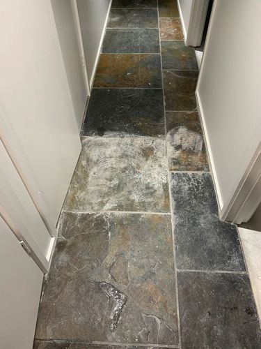

any adea how to clean that white staff on that tile .it happened when we try to clean few paint drop and use methylated sprits and with water after and that white staff come up thanks

I recommend not using methylated spirits on your flooring. The methylated spirits have had a chemical reaction to your floor sealer and has turned it white. Using more of the metho will further damage your floor. I'm afraid that it can't be repaired using D.I.Y. methods.
I recommend engaging the services of a flooring specialist to fix this damage. They have the tools and knowledge to repair it safely and properly. Because the seal has been damaged the flooring specialist will need to strip the sealer along that area, they will then reseal it in order to return your flooring back to its natural colour.
