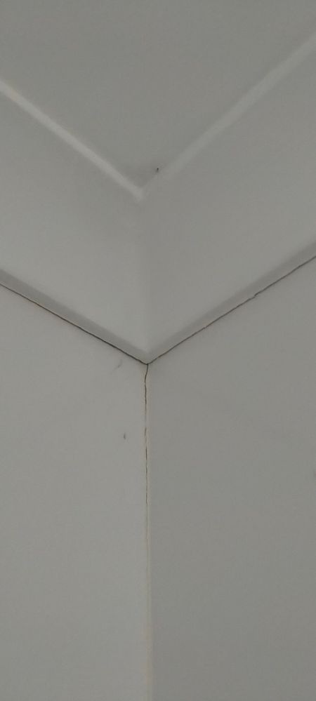

The bathroom was resealed around 5 years ago but there are gaps showing in the corner of the walls and I have decided to scrub the ceiling corners and tiles as well but on closer inspection the silicon looks like has crumbled and turning yellow as the cause of the scum.

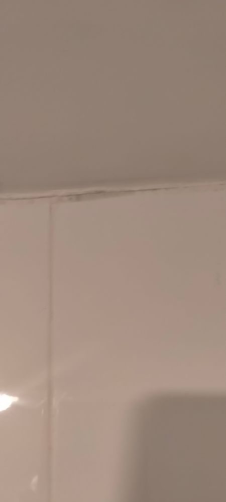

Silastic brown in colour

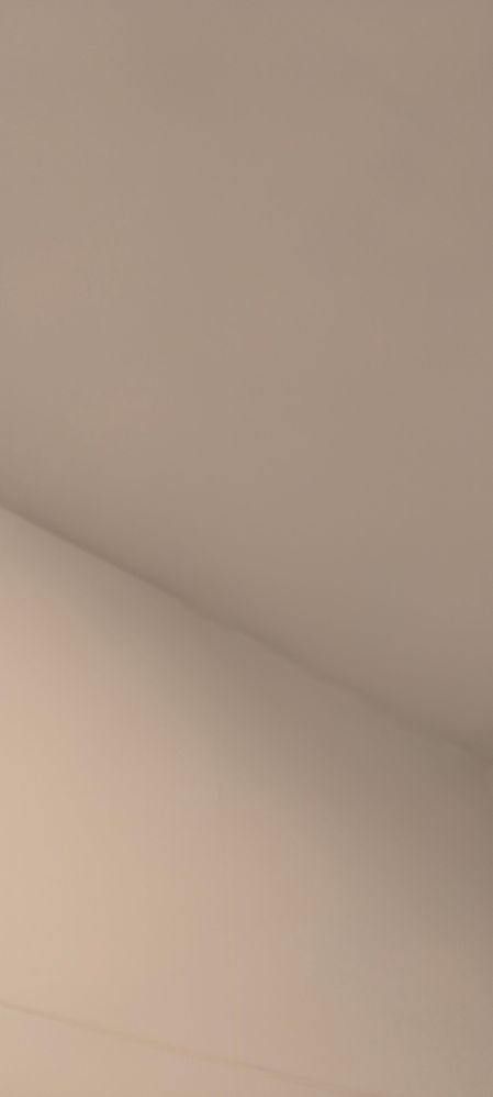

Silastic on tiles and ceiling after scrubbing. maybe a blade on tile and a ceiling painting but first something to cover the silastic and then paint over?
Silastic

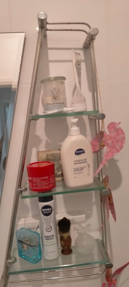

Rusty Chrome

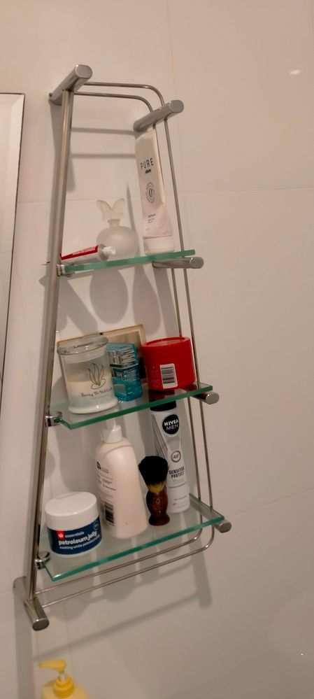

Don't think I will find this shelf new or something that will fit existing holes so to the chrome shop

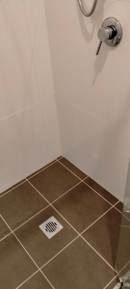

Water from shower screen
Water travels from under shower frame from silastic failing.

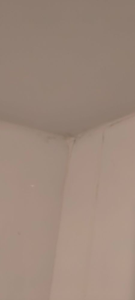

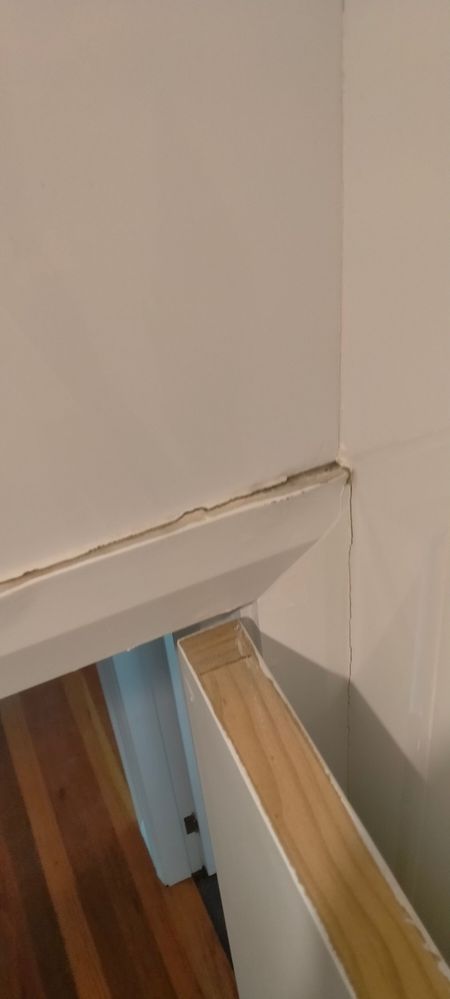

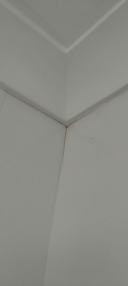

Bathroom wall separation
The cause of shower leaking in report to be sealed and painted
Other corner

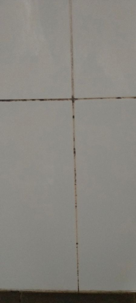

Grout condition

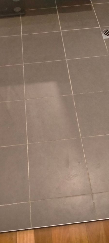

Floor tile condition
Needs rejuvenation on walk surface

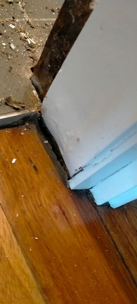

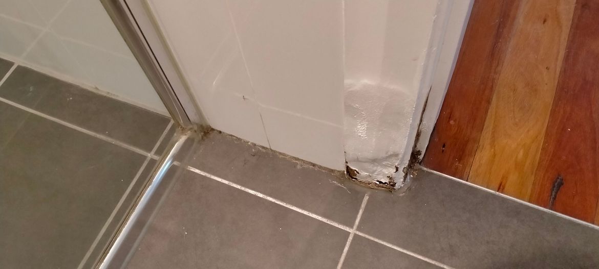

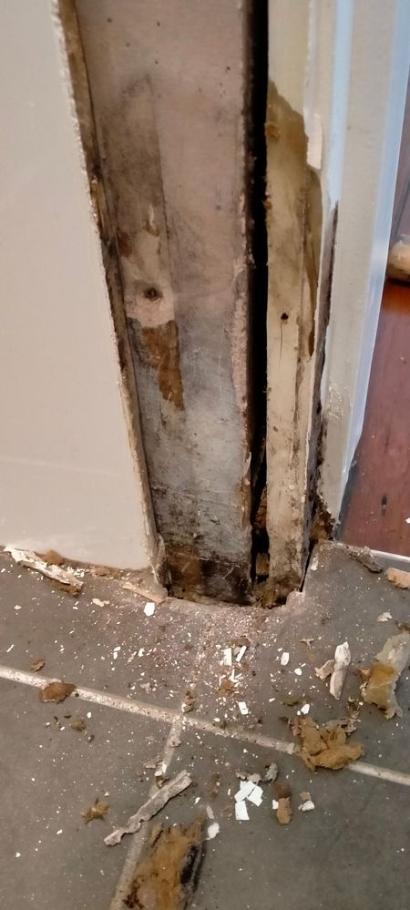

So today I have started destroying the bottom bathroom.

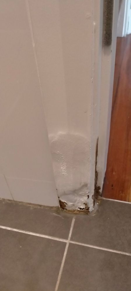

Bottom Door

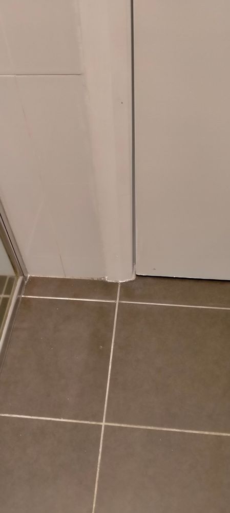

Removed architrave
Door frame
Scary removing the door architrave and worried I may damage a tile so I was careful. The bottom of the door is rotten into the hall floor.
Can I replace these panels separately or do you need to replace the whole door frame?

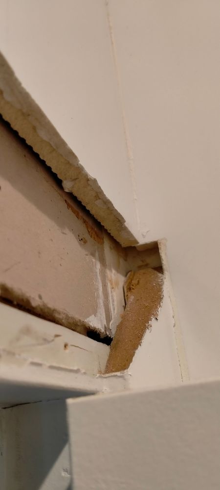

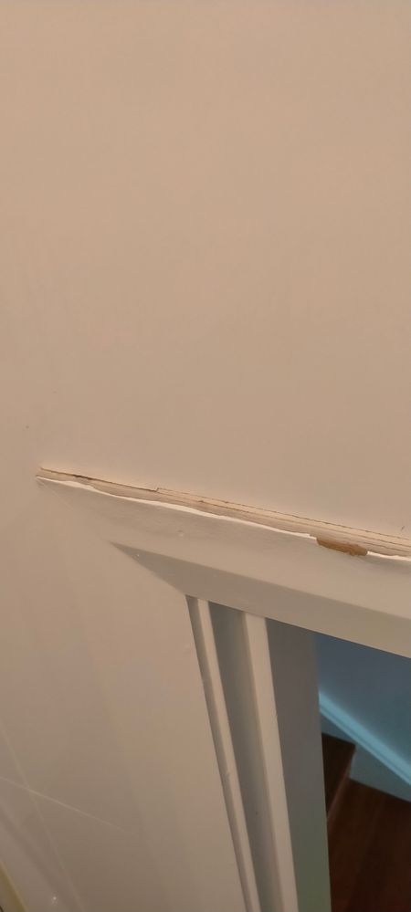

Top architrave
The architrave that runs along the hinges is not too bad and is sunk into the tiles. While I am sure I could get it removed without damage to the tiles I see no rot.

Hi @Kvic,
The rotted timber that runs into the hall is the door jamb. You'll purchase these as sets, but you'll be able to install just that one vertical side. Pulling that side of the door jamb off the stud work might take some force. You'll need to pry it off with a wrecking bar. Here's a helpful step-by-step guide: How to install a door jamb.
Is the yellowing shower seal an actual profile? Or is it just silicone that's been caulked into the corner?

Wet and Dry with chrome Polish
An hour of rubbing and cleaning the rack is nearly as good as new.
