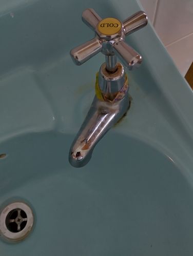

I would like to connect a threaded washing machine hose to a wash basin tap without threading. Wondering if there are any adapters that would work. Your support is highly appreciated. Thank you.
Welcome to the Bunnings Workshop community @SG-. It's wonderful to have you join us, and many thanks for your question about connecting to a tap spout.Unfortunately, that spout doesn't have a threaded aerator, so there's nothing for us to start adapting from. Are you able to access the plumbing work under the sink? There would be a far better chance of attaching your washing machine inlet hose there. If you can access that plumbing work, could you take a picture of us so we can assess whether that would make a suitable connection point?Please let me know if you have any questions.Mitchell

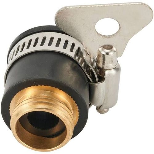

Thank you very much for the warm welcome and prompt reply. I have attached the requested picture. I saw an adaptor online which might work. I have attached a picture of it. My knowledge on plumbing is very limited. Kindly advise if that would work and if Bunnings has them. My knowledge on plumbing is very limited.

This looks like a possible DIY solution if you can get enough of the end of your tap within the rubber seal for a leak free connection. Remember the connection will be under on/off water pressure during the washing machine cycles and it might be risky leaving it unattended. A better solution would be to use a licences plumber to make up a split connection where the braided hose is connected to with an isolation tap for the washer. Only a plumber can legally do this work to be covered by your insurance.
As @Nailbag has mentioned, @SG- it would be best to have a permanent connection made where that plumbing connection is in your most recent image. Connectors like the one you've shown run a significant risk of popping off and then potentially flooding your home. They are certainly not to be left unattended. I believe we kept a similar connector at one stage, but it has now been phased out.
