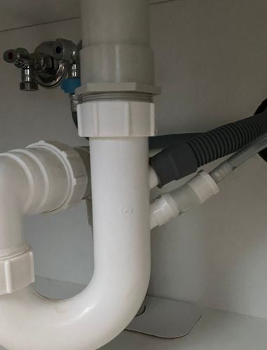

I've discovered a very neat solution for this. Buy one of these connectors from ebay:
Then buy a small length of 20mm clear PVC hose from Clark Rubber or similar:
(Bunnings has 19mm tubing which would probably do the job with a bit more effort to stretch it on:)
And connect them like this:
You might want to add hose clamps but you don't have to as this is neat and secure, and does not leak. All for not much more than $10 - and you'll have enough tubing left over to do a dozen or so more if you need to.

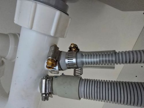

 I used 16mm vinyl poly heated one end then pushed it over thev19mm spigot. Then pushed the drain hose all the way into the spigot and jubilee clipped both ends.
