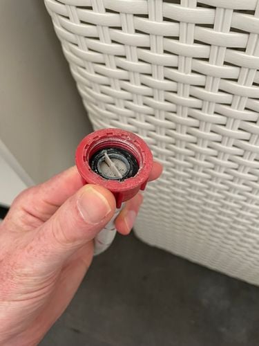

I’ve moved into a new house and attempting to connect up my Fisher & Paykel Washsmart washing machine.

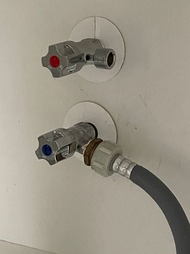

Cold tap under sink - no problem. Hot tap - problem.
The hose end is roughly 25mm which I think is pretty standard; the tap is 20mm.
I can see the previous owners have used thread seal tape and some kind of other adaptor to attach their cold hose, but I can’t figure out what that adaptor is and I’m not too keen to pull it apart to find out!
Any ideas?

If your measurements are correct, then you would need a Brasshards 25 x 20mm Brass Threaded Hex Reducing Bush which is what they've used on the other tap. Thread tape will need to be applied to the existing thread on the mini cistern cock before installing the bushing.

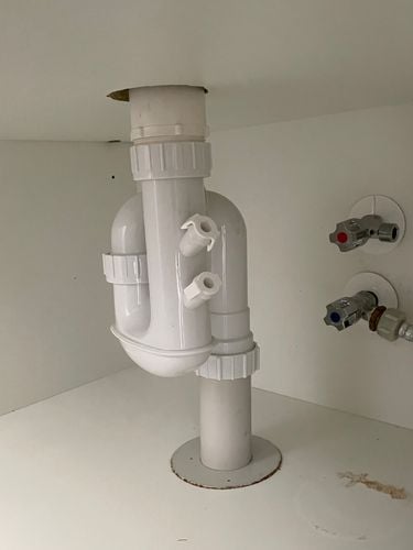

I'll also need to connect the outlet hose. I've read through this post: https://www.workshop.bunnings.com.au/t5/Bathroom-and-Laundry/What-fitting-for-washing-machine-outlet...
I've picked up a hose clamp to complete the job but I'm still a bit unclear which nipple I should attempt to attach it to. Is there a difference between the top and bottom one? Any guidance much appreciated!
Re: How to connect hot water hose from washing machine to 20mm tap under sink
There's no difference between the top and bottom nipple @damian22. I'd pop the outlet hose on the top one as it puts it slightly higher than the water that constantly sits in the S-bend.
