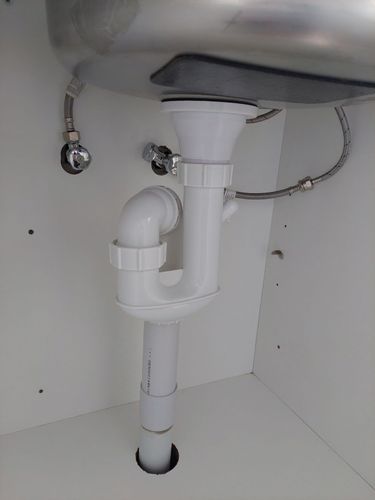

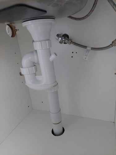

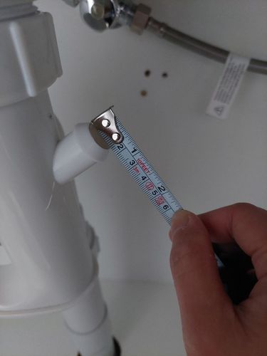

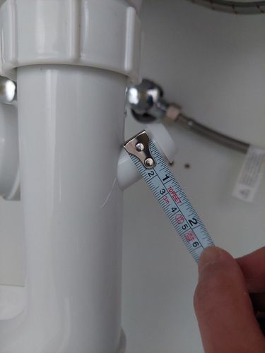

I have a washing machine and a dryer and want it both drained. However I just found that the trap under the sink only have one nipple for drain hose.
Is there any parts can let me connect one nipple to two hose?

I think you might be able to buy a T from the section bunnings sell rain water harvesting things and garden watering systems. You will need a bit of a similar hose to connect the T to your drain.
Can you just use a bit of 19mm clear pipe or similar (Pope 19mm x 90cm Clear Vinyl Tubing - Bunnings Australia) to a T piece? But guess a T piece would let water flow into the other drain which may cause issues, I have seen dual nipple s-bends but might not be as easy to find one that fits the current setup.
Don't know how easy it would be to maybe drill a hole and put a second nipple in.

The best method to attach both pipes from your washer and dryer is to replace the existing trap with an S&P Fix-A-Tap Trap. This trap has a provision for a second waste. I've placed an image below to give you an idea of what it looks like.
Please note that this product needs to be specially ordered at the special orders desk. The Fix-A-Tap code number for the product is 216199. I suggest asking the special orders team for a quote before purchasing the product.
Please note it might be necessary to engage a licensed plumber to complete this work. If in doubt, consult your local building authority before starting.
