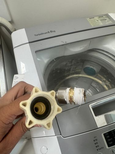

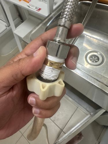

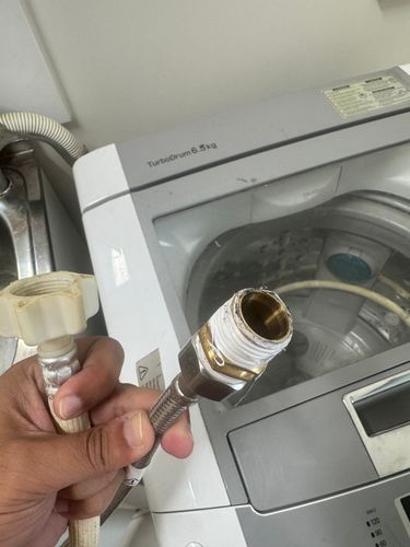

I moved into new house, the water inlet hose fitted is different size from my washing machine hose. Is there any fix or adapter I can buy to connect both.

It looks like the mismatch is between the 15mm fitting on the steel flexi hose and the 3/4-inch thread on your washing machine hose. A common solution is to use a fitting such as the Brasshards 20 x 15mm Brass Threaded Hex Reducing Bush LF, which would allow the adaptation of the 15mm thread to suit your washing machine connection.
That said, adding or altering fittings like this can be considered plumbing work, so the safest approach is to have a licensed plumber install the adapter for you. This way, you’ll know the connection is secure, watertight, and compliant.
