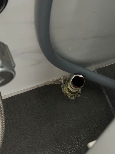

Just moved home, and the new place has a very short standpipe for draining purposes. The diameter is about 20mm, too small for my washer's drain hose. Is there any connector or sort of funnel available to allow me to connect? Thanks you!

What size diameter is your drain hose on the machine? You'll need to adapt it to suit the size of the standpipe. Make sure that the standpipe is large enough that it complies with the machine's specifications. If the drain is too small, it can cause issues with drainage or the pump motor to burn out.Adding a funnel might not be the best idea, as if there is any blockage of the standpipe, water will be pumped out over your floor. We do have the Kinetic 4.1m Grey PVC Washing Machine And Dishwasher Outlet Drain Expandable Hose, which you might be able to use to replace the current hose on the washer or extend it. It has ends that can be cut back to reveal several different-sized adaptors. There's also the BOSTON 1.2 - 4m Expandable Washing Machine And Dishwasher Outlet Drain Hose that you could try.
