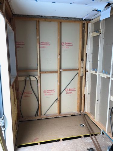

@Nailbag I also meant to ask, do you have more photo's or a thread that documents your shower base contruction?
It looks like you screed your base, is that right? I assumed you waterproof the yellow tongue and surround, then screed after? Do you waterproof the screed again after that, or is that not necessary and you can just tile straight on the screed?

Hi @squeakysim, these are the layers.
  • Yellow tongue floor
  • Tile underlay
  • Screeded shower base
  • 3 x coats of waterproofing membrane.
  • Tiles

Hi @Nailbag ,
Where you dropped the shower base and then did the screed, did you put any kind of expansion joint between the screed and the adjacent subfloor, or did you just screed right up to the floor level and then just waterproof over the join?
I've struggled to find any videos or otherwise that shows the installation of a puddle flange and screed onto a suspended floor, they all are on concrete slabs. When it's a suspended floor they always seems to use somekind of pre-formed shower base with a built in fall. I've read various things and seen cross sections or what the layers finished waterproofed floor should look like on a timber floor, but nothing that really shows what happens with the join where the screed meets the adjacent subfloor!

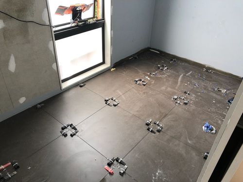

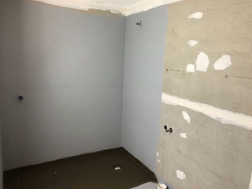

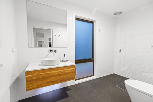

I basically was following the instructions by my tiler or also is a certified waterproofer.
I dropped the floor - fitted yellow tongue - fitted cement sheet underlay to the entire floor - fitted the puddle flange. So, no expansion jointing as the waterproof membrane is highly flexible.
Then I left it to the tiller to screed the shower base. Once dried it had 3 coats of waterproofing over 3 days. Being winter, I bought a $20 electric heater and left it on low over night to ensure it was 100% dry between coats which makes a massive difference to the waterproofing.
These are pics of the ensuite, but I did the same for the main bath.
