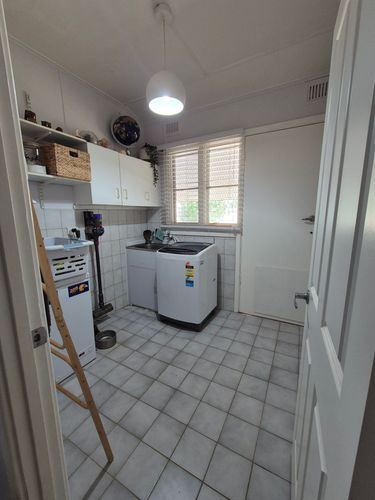

I was wondering if you would please be able to help with a layout design plan to renovate our laundry. Ideally would love to add a shower in someone if the room permits.
The measurements are as follows;
2400 wide
2270 long
2720 ceiling to floor
Pics attached
Thankyou

I suggest having a quick look at this guide - How to plan a laundry renovation by @Adam_W. It will give you an excellent idea of what to take into consideration when planning your laundry area. Your renovation request is quite special as you are asking if it is possible to squeeze in an extra shower in the space provided. I believe that there is just enough space to make it work. Please keep in mind that this will require your laundry area to be completely stripped out and re-assembled with the proper waterproofing membrane installed.
Before you begin, I suggest engaging the services of a builder who has experience in upgrading standard rooms into bathrooms. I recommend asking for a quote on what needs to be done and how much it will cost to transform your laundry into a bathroom. I also recommend checking your local council's rules and regulations in regards to the transformation of the room.

As promised, I've placed some images below to give you an idea of how you can lay out your laundry with a shower in it. I've designed it with a front loader to give you an idea of what it might look like, but it will still work even if you have a top loader installed in that spot. I've placed an extra wall to create a shower cubicle which means that you just need a shower door to complete the set-up, and it allows you to adjust the depth of your shower area. It also defines the area between your shower and the laundry.
It gives it a nice classic look and provides your shower with excellent privacy even when people walk across the laundry rooms window.
