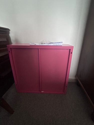

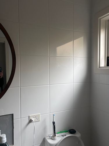

Hi, I need to put up a small metal cabinet. Its probably 800mm x 800mm by 120mm deep.

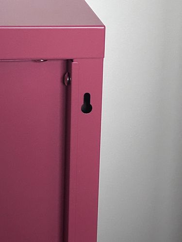

Based on where it needs to go it is unlikely I will find a stud. I know that these tiles are on a cement sheet product. The back of the cabinet has 4 small slots to enable the cabinet to be lifted above. The kit comes with a template so you are clearly limited to drilling as per template
the screws and then slide down into place

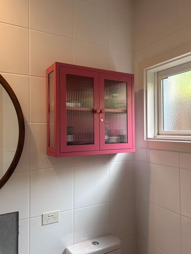

Thanks everyone. Looks great and been up for over an hour without falling 😉

100% those spikes will compress as you push the plug through regardless of depth. And yes they stop the plug from spinning. The MOST important point is using the right sized glass and tile bit. Too small and it wont fit properly. To big and it will spin when you tighten the screw if with the spikes. I'll be using the smaller red and white ones myself tomorrow to fit out a new bathroom with rails and hooks etc.

Thanks for your help. Job done and looks great and importantly its solid
