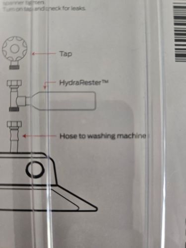

That certainly doesn't sound right. I've spoken to the Sioux Chief team, and they've suggested the most likely explanation here is a faulty unit. I do apologise for the inconvenience. If you can see our team in-store we'll swap the unit over. If you continue to have issues, we'd need to elevate it to the Sioux Chief technical team for assessment. From your image, you do appear to have it installed correctly, though.

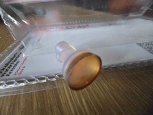

When removing the uint to swap it for a new one, a clear plastic bunge fell out of the Arrester as shown in the picture below.
There is no notice on the instructions but now after reinstalling the arrester without the bunge the unit is working as advertised & water is flowing.
Im not sure if the bunge is part of the system or not ? Or something left in from manufacturing  ?
But all seems to be working well & no banging pipes.
Cheers  MC

The plugs or bunge as you refer to them are there to protect the mechanism of the water arrester. If you installed it with the bunge installed it would definitely not function properly. But now that you've removed the bunge it should now function properly.
