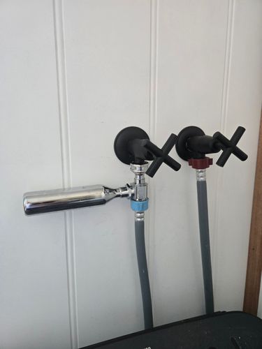

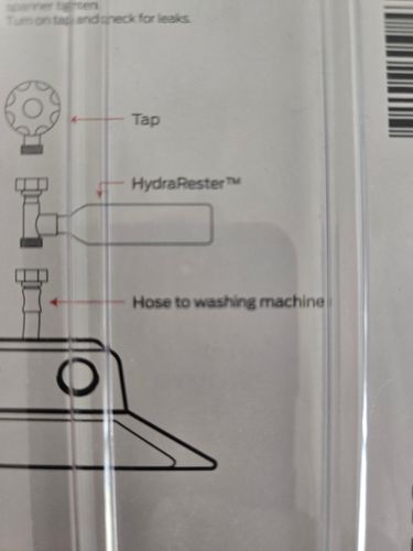

Hi, just installed a new Sioux Chief Water Hammer Arrester ( 20mm Size A) onto my washing machine.
Install was quick & easy but now when I start a new cycle of washing, no water going into the machine during its pre programmed sequence.
When water is about to flow, you hear a quick hiss of air from the Arrester Unit.. but no water flow.
Ive removed the unit & re installed, but still no water flow. And yes, the water is turned on and flow check while the Arrester was removed.
And tips ? Or could it be a faulty unit ?
