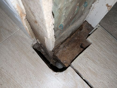

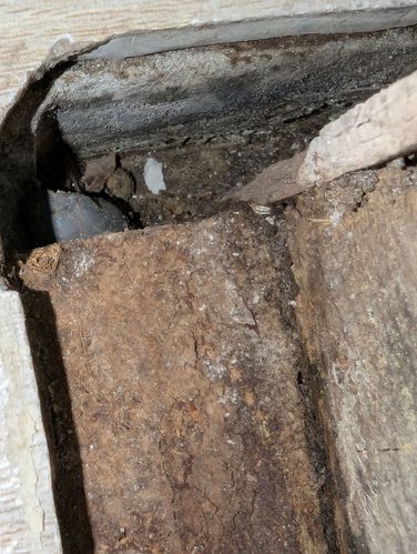

Hi all,
I have been fixing a bathroom shower leak and had to remove a rotted door moulding that was embedded into the floor mortar. The rotten moulding appeared to have waterproofing applied to its exterior after it was attached to the door frame, so it was part of the bathroom waterproofing. I want to fill the void and replace the door molding above the existing tile level but am concerned about the gap created in the waterproofing. Do you have any suggestions for waterproofing and filling the void. Should a waterproofing coat be applied into the void before filling? Would you use a waterproof filler to fill the void (eg. an epoxy grout or hydraulic cement based product like Water Plug)?
Any thoughts or suggestions welcome.
