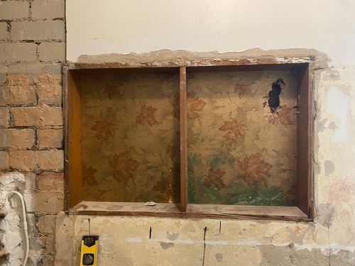

Hi all. I’m renovating our ensuite and currently have a wall cavity from a previous recessed shaving cabinet. I want to fill in the cavity as will be installing a flat mirror. The mirror is oval in shape and doesn’t cover all the cavity and I think my preference is to fill the cavity completely and render over the top to match the rest of the walls in the ensuite. Would it be best to remove current wood frame and then brick it out and render over the top? or is there a better solution. Any guidance, advice appreciated.
