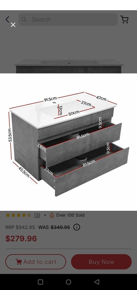

We are planning to renovate our bathroom and started with buying vanity . We thought it is a package that comes with vanity storage+Sink , but it came only with storage cupboard.
I am sharing here the online bought vanity, can you please help me with finding the right sink for it.
First picture is vnaity brought online. Second one is what I found online the closest with one mixer tap.

Thank you for sharing pictures of your vanity cabinet. There are two options open to you when it comes to getting a top for your vanity cabinet. I recommend getting an actual measurement of your cabinet. I'm aware that measurements are stated on the picture, but we are after the measurement of the cabinet by itself. Once you have the measurements, I suggest visiting your local store and checking the Estilo 900mm White Polymarble Vanity Top 1TH and the Mondella Rococo 900mm Ceramic Vanity Basin With 1 Tap Hole to see if they are adequate for your vanity cabinet.

However I have a question about the measurements, the vanity storage shows length 91.5 and width 47 but the this sink https://www.bunnings.com.au/mondella-rococo-900mm-ceramic-vanity-basin-with-1-tap-hole_p4844312 says width 905mm and length 465mm.
Am, I understanding this wrong?

You've read the measurements correctly. However, I suspect that the measurements indicated in your picture are of the vanity top and not the cabinet size. I encourage you to measure the cabinet that you have so that you can double-check the size of the vanity top against your cabinet. I believe that the vanity tops I've recommended could possibly work with your cabinet.
