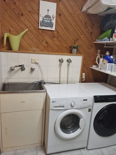

how to fit and support benchtop above the washing machine and dryer with the tiled wall jutting out

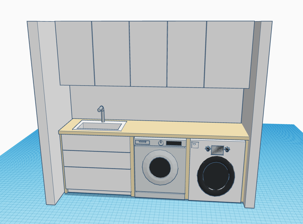

I had a similar situation with my laundry. As the most straightforward option, I opted to cut a laminated panel down and use it for the leg supports. It gives a really neat boxed-in design. I'll add a rendering below to illustrate. However, I went with this method as I couldn't make any permanent changes to the layout. In your case, I'd highly recommend you take this opportunity to change the tub out for an insert sink and create a larger benchtop. With the addition of some cabinetry on the wall and beneath the sink, this area could become highly functional.
I think you'll find once you install the benchtop, you'll want to replace the tub soon after. Given this, it would be worth considering doing it all at once. Check out this neat guide on How to plan a laundry renovation.
Thanks Mitchell. The tricky bit with the laundry tub is that it is built in such that it sits beneath the tiled wall and also below the tiled floor. I'm not sure how to fill the gap if I were to pull it out. I thought of just spray painting it to give it a lift as a start
That does make it a little more challenging to remove @kagomechan. I still wouldn't rule out removing the tiles and redoing them once the larger bench is in. The new floor sink cabinet will likely cover any areas on the floor where there are no tiles currently.
Installing the simple bench will make a world of difference by itself. However, I know from personal experience that it's worth considering a slightly more substantial reno.
