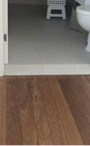

Hi, I’ve just had my bathroom rendered Ive been left with a 50mm lip (drop) between the bathroom door frame and lounge room floor. I was quite upset but told this was required. I’d like to know how I can make this less of a trip hazard. I’ve been looking a quad moldings but none are 50mm that I can find. I’m thinking I may be able to glue one ontop of the other to get the height required - would this work? Open to all suggestions

Thank you, the low point is the hallway floor…yea I questioned this repeatedly as unhappy. However I was told due to concrete floor, building code standards today, and the need to ensure overflow escape that this was ‘normal’ practice. I did suggest I’d pay to have redone but told it may only give a few mm difference. I’m thinking of asking if they would create slope like picture below. Do you think this may be best? Only issue is prob the floor tile I picked out 😞

A tiled slope could certainly be an option @mzlink. Due to the large height difference, it would have to be a very large moulding or a combination of some to stop this from being a trip hazard.

I would go for some sort of timber moulding or look into having a metal type made up. The sloped tile suggestion I think you will trip up more so (I know I would) but a step would be more viewable for sure.
Maybe two pieces of quad to make up the height, A smaller square/rectangular piece on the bottom and a curved one on top. Or go for a Larger rectangular piece with a metal edge? Roberts 8-14mm x 1.65m Silver Multi-End Trim as an indicator of what to puty on top of the rectangular piece of timber.

Thanks everyone for your input. Spoke to builder and clarified what I wanted with recommendation of  2 pieces of quad! and smaller flat piece at bottom … I’ll post pic when installed

What I ended up doing- the space actually was 45mn , so  I found a 42mm quad piece, adding some packing to the bottom and then sealed it up. I decided I liked it raw so I need to add some clear poly on it. it’s not perfect but better!
