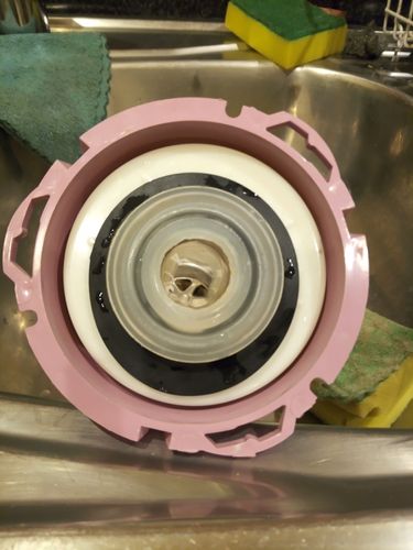

Managed to move the washer into a better position using detergent and noticed how it fits better under the clear plastic now. Still having the same leaking problem though. Will persevere....Arggh! lol ![]()

Looks like I've failed outlet washer replacement 101. The area beneath is clean and free of debris. Any tips on getting this little devil in place properly? It seems to have a mind of its own! I watched some youtube vids and some suggest using liquid detergent.

Hi @Easy1520,
It's in the right place, but your washer is too small. The washer should cover the entire white section at the base of the valve.
Can you advise what the diameter of the white plastic piece is?
I suspect this FIX-A-LOO Seating Washer - Suits Caroma Duoflo And Thunderflush is what you should be using.

I've used the "FixALoo Seating Washer - Suits Caroma and Dux". Its dimensions are close to the Duoflo. But seems not close enough.
Sealing Washers:
Suits Caroma and Dux: Washer Dimensions: Outside Diameter: 62mm, Inside diameter: 24mm, Washer thickness: 1.70mm.
Suits Caroma Duoflo : Washer Dimensions: Outside Diameter: 66mm, Inside diameter: 25mm, Washer thickness: 1.60mm
I'm sure you're right though, so will get the one you recommend and see how I go.
Thanks very much for your help. Very much appreciated!
The pic is a bit misleading. The diameter of the white plastic is about 78mm.

Hello @Easy1520
Getting a matching seating washer for the traditional flushing valve of your Caroma toilet can be a challenge sometimes. In my experience the Kinetic Seating Washers - 2 Pack (the red one) is a much better match to the Caroma set. The use of dish washing soap is an excellent technique to center the washer, but I recommend using a massaging movement as you go around the seal. Your goal is to center the washer to the seat, take your time and don't rush trying to center the seating washer. It can get a bit wearisome but be patient, the washer will center itself and will seal the toilet valve properly.
An update on all your good advice is that the Kinetic washer has worked. Yay, hoorah and thanks again!
I think the one recommended by @JacobZ will also likely work so I bought both and will keep it as a spare when needed for the second cistern in the house.
