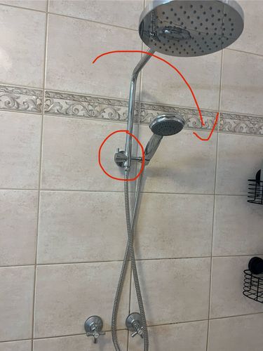

we are having trouble with our Estilo 3 function 1/2 twin rail shower set. The diverter piece doesnt seem to hold tight and the shower head is tipping to the side.
I cant tell if the diverter is spinning on the nipple or the nipple connection to the pipe in the wall (but this seems to be tight). I have tried to tighten the pressure screws as tight as i can, but it still seems to be quite loose.
any help would be greatly appreciated!
thank you! 
John

Since you have tried to tighten the screws of the assembly and the head is still oose, I can only suggest removing the screw and applying a very strong adhesive to the arm assembly to keep it permanently in a single direction before putting the screw back in. Another option is to install a Flexispray Chrome Bermuda Shower Bracket on your tiled wall in order for the shower to be mounted in a fixed position. Because the diverter and the shower head arm are integrated into the body of the shower it can't be ordered as a spare part.
Here is a link to a discussion that describes how the bracket is installed on the wall - Solved: What shower head holder? by @RenoFun
