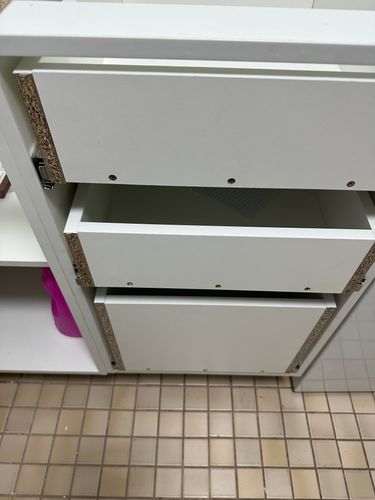

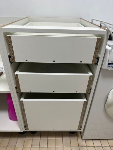

First photo when pushed in hard.
 This one shows top drawer pushed in hard but second not pushed in hard just pushed to close.

One of the common causes of drawer misalignment is the drawer runner level. There is always the possibility that the guide holes placed in the cabinet were out of alignment. This would cause the runners to be at different levels and creates a tight fit for the drawer. The tight fit causes the drawer to malfunction.
I suggest trying this repair method, remove the tight drawer from the assembly. First, I need you to test that the drawer runner is functioning properly. Pull the drawer runner mechanism out and push it back in. The soft close system should work even without the secondary part attached. If it does not work however, this means that it is defective, and I recommend bringing it back to the store for an exchange.
But, if you've determined that the runners work perfectly, I recommend taking accurate measurements of the level of the drawer runner mechanism. Make sure that they are at the same height and use a spirit level to determine if they are true and level. If it is out of alignment, make the necessary adjustments by loosening the screws or drill new supporting screws to the correct level.
Please give this repair suggestion a try and let me know if it works. If you still have issues with the runners, I recommend bringing the drawer runner mechanism for an exchange.

After checking the level of all runners and testing the drawers in different positions it became clear that the problem was with the runners on the side panels of one of the drawers.
Pulled them off and redid them and now all working as they should be!

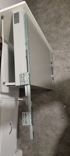

c, how do you remove the draw from the sliders if it has become completely detached from the cupboard

Can you please tell me if this is a Kaboodle drawer runner? Can I please request for a closer photo of the runner itself, particularly the front end where the release clip might be located. there are two possible options for this type of drawer runner. It either has a release clip that you need to push to allow it to separate from the main body of the drawer, or it is a force fit clip system which means that you need to pull the front end of the drawer down to release it from the main body.
I propose having a very good look at the drawer runner and investigating its parts. Put it in the open and closed position and try to look for a release mechanism at the front. Please let me know if you make any progress.
