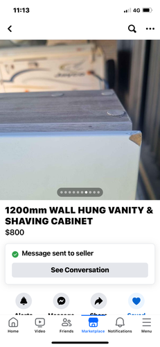

how would I repair a 2cm chunk off the corner of a white laminate shaving cabinet
Welcome to the Bunnings Workshop community @stratton. It's wonderful to have you join us, and many thanks for your question about repairing a chipped cabinet.You'd likely need to fill the area with a tiny amount of Builder's Bog. Once it has dried, you must sand it back with 180-grit sandpaper to re-create the corner. You'll then be able to prime the corner and when dry, paint. Be advised that it would be tricky not to damage the surrounding area whilst completing this process, so you should mask it off well with a couple of layers of painter's tape. Even after the repair is complete, you'll probably still notice it, but others who are not aware of the damage will most likely not.Please let me know if you have any questions.Mitchell
