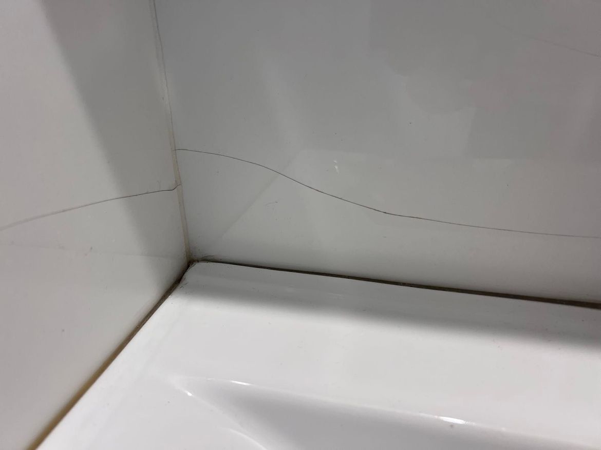

Hi Guys
Does anyone know how to fix the crack on the bathroom tile?
Welcome to the Bunnings Workshop community @JK8486. It's great to have you join us, and many thanks for your question about repairing a tile.
Unfortunately, there’s no way to fix a cracked tile without replacing it, as the integrity of the tile will be compromised. However, if replacing the tile isn’t an immediate option, you could try to disguise the crack to make it less noticeable. One approach is to rub a similar coloured paint into the crack. You can use an acrylic paint or porcelain repair kit that matches the tile colour. This can help fill the crack and blend it in with the surrounding tile.
Be cautious when working with cracked tiles, as the edges may be sharp and pose a risk of cutting your fingers. If the crack is extensive, it’s worth considering replacing the tile to prevent any further damage.Please let me know if you have any questions.Mitchell
