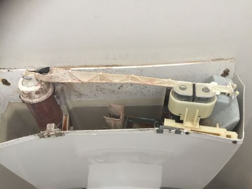

We have a 20 (?) year old toilet that works like a rocket apart from one thing; after flushing, it leaks/ makes a leaking sound. In other places we’ve lived, it was simply a matter of bending the METAL arm of the ballcock which instantly solved the problem. With this one of course it’s all PLASTIC so would potentially snap if any adjustments were made. I have noticed- as per the photo- there is a black plastic thing at the end of the arm that looks like it could potentially be moved? Yes- I know we could open our wallet and pour money into buying a new toilet, etc. etc. but that feels like an unnecessary step given I suspect there is probably a much simpler solution. Second photo included to give the ‘big picture’..

I've placed some directions below on how to disassemble the inlet valve. You'll need to use the Kinetic Assorted Ballcock Washers, specifically the white washer and one of the black rubber seals. Once you've disassembled the inlet valve you'll find a piston inside the assembly. The white washer goes on the piston and the rubber skirt must face down. In the middle of the piston is the black washer, the old one must be removed and the new one installed.
Re-assemble the filling valve in the reverse order, please make sure to test the unit before you cover the cistern. Should the inlet valve fail or is too old to be repaired, I suggest replacing it with a Fluidmaster Bottom Entry Toilet Inlet Valve. It's compatible with your toilet cistern and is fully adjustable.
Personally If you are going to have to remove it to replace the rubbers Id replace it with a Fix-a-loo that way everything is new. Cost about $25 at Bunnnings. Turn of water, flush tiolet, disconnect hose from bottom of cistern, undo bottom nut remove existing filling valve and put new one in place. Switch water back on and adjust water level. Takes longer to get part than to do job. JDE
