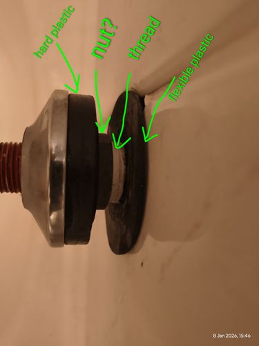

Also, I can see that the previous owner (?) has already put a black plastic thing behind the outlet point - this also is not siliconed in place and I don't feel particularly confident about it keeping our water. Perhaps I could change the outlet too?

That black plastic piece behind the spout does look like a bit of a makeshift spacer. My suspicion is that the threaded spigot coming out of the wall is too long, so when the spout was screwed on, there was a large gap left behind. It looks like someone’s tried to fill that gap with plastic or possibly electrical tape. If that’s the case, then replacing the outlet might indeed be worthwhile. You may just need to cut the protruding threaded spigot back a little to get a proper fit; it’s not a huge job, just something to be aware of.

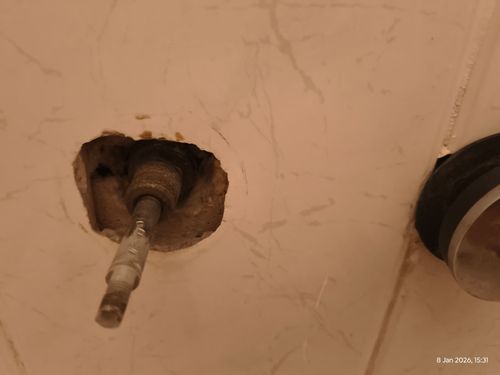

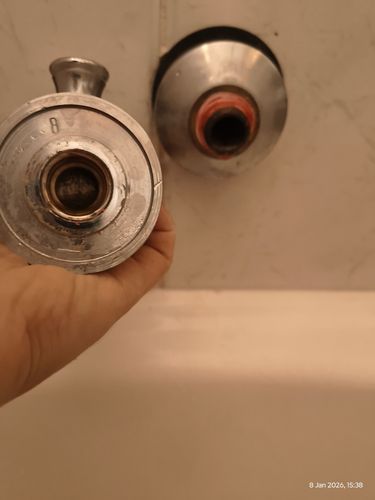

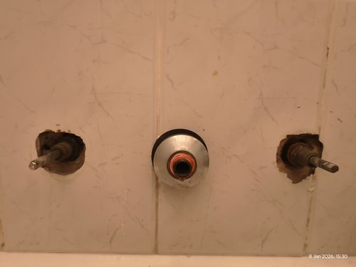

Hi @MitchellMc, here is my update.
I have removed the tap handles. The spigot is proving tough to undo on the Right side. I've sprayed it with WD40 and will use a tube spanner to get it off. I am concerned however that it may cause damage to the piping underneath?
The tap on the left side has a spindle sunken into the wall. I will use the same technique as the right side. 
The centre pipe, where the bath outlet sits does not seem to have a spindle? Also, I am not able to undo the centre flange (however, have not used much force in case I break something). However, if I can undo the nut, perhaps I do not need to take it off?
Previously we planned to shorten the spigot with a hacksaw, but since there is not a spigot, I am now not sure what to do.

Hi @smie,
From what I can see, this is a classic case of a DIY workaround that has made things a lot more complicated. The centre spout assembly has multiple layers: the flexible plastic gasket, a hard plastic spacer, the nut, and then the chrome cover. None of that extra material should really be there, which is why the spout is sitting proud and everything looks awkward.
Here’s how to approach it safely: first remove everything that isn’t original to the tap/spout assembly. Start with the chrome cover, then the hard plastic, then the nut, and finally the flexible plastic piece. Ideally, this should leave you with just a threaded pipe coming straight out of the wall. That threaded pipe is what your spout should screw onto.
Regarding the side taps and spindles, if they are stuck, keep using your WD40 and tube spanner method, but take it slow. The spindles themselves control the water flow, so be careful not to damage them. Once the spindles are out, you can decide whether to replace the taps entirely or just re-seat them with the existing cover plates and a bit of silicone around the edge to seal it.
For the centre spout, once all the excess pieces are removed, you likely won’t need to cut or shorten anything. You can then slide the spout over the threaded pipe and secure it. This should give a clean, secure finish without the complicated stack of DIY parts currently in place.
