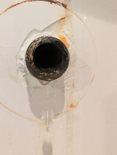

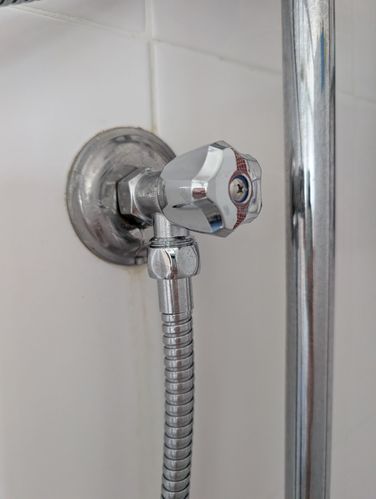

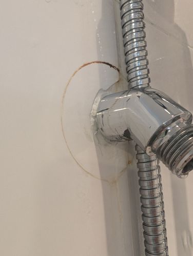

Thanks Mitchell. My new wall elbow has ability to shut down the water and because I haven't been able to open the Taps, I  have turned the water off from the elbow and that has stopped the leak for now. Do you think this is

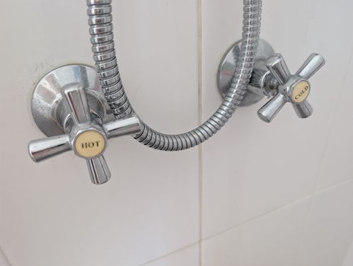

ok? Please see picture attached. I have also attached photo of my taps.
Thanks again.
Re: shower leak
That's a novel way of resolving the issue, which will likely work, @Pauliina.
I see what you mean about the taps. Those cone-shaped cover flanges can be notoriously hard to undo as the tapered sides are not much good for grip.
There are a couple of solutions. The first is to destructively remove them with adjustable pliers. The teeth should bite into the metal, but they'll destroy it in the process. This isn't the worst thing, as a new set of wall taps in a similar style like the Estilo Chrome Wall Top Assembly Set will set you back $29, which include the washers. Since replacement washers for your set will cost at least $5, it's not such a bad deal.
The second option, which could also cause damage to the taps, is to remove the tap handles by removing the Hot/Cold buttons. You can then grip onto the end of the spindle and try to use it to back out the spindle from the wall. Certainly not a recommended approach, but if all else has failed.
Re: shower leak
Thank you Mitchell. You have been very helpful 😊. I give it a try with pliers.
Re: shower leak
Specifically, you'll need multigrip pliers, @Pauliina.
