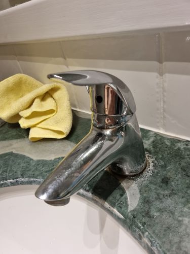

Started with leaking tap, we thought we had to change the mixer cartridge. After removing the little blue/red cover and little screw inside, we expected the handle would come off easily, but it didn't. We tried pulling really hard, sprayed WD40 and left for a few hours, pour got water over it, it only came up a tiny bit, I'm worried I might break something inside. Brand of this tap is Zuccheti. Advice please.

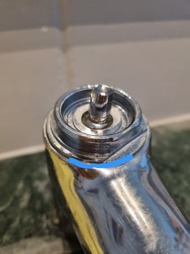

Hi Jacob,
Thanks for the advice. The handle came off finally AFTER soaking with CLR.  Although we got the next problem. The whole thing underneath seems to be one piece. Would you mind sending a link to the drawings? Or do you know if the blue line in picture is where we can separate the rest of the tap?
Regards
Xiana 

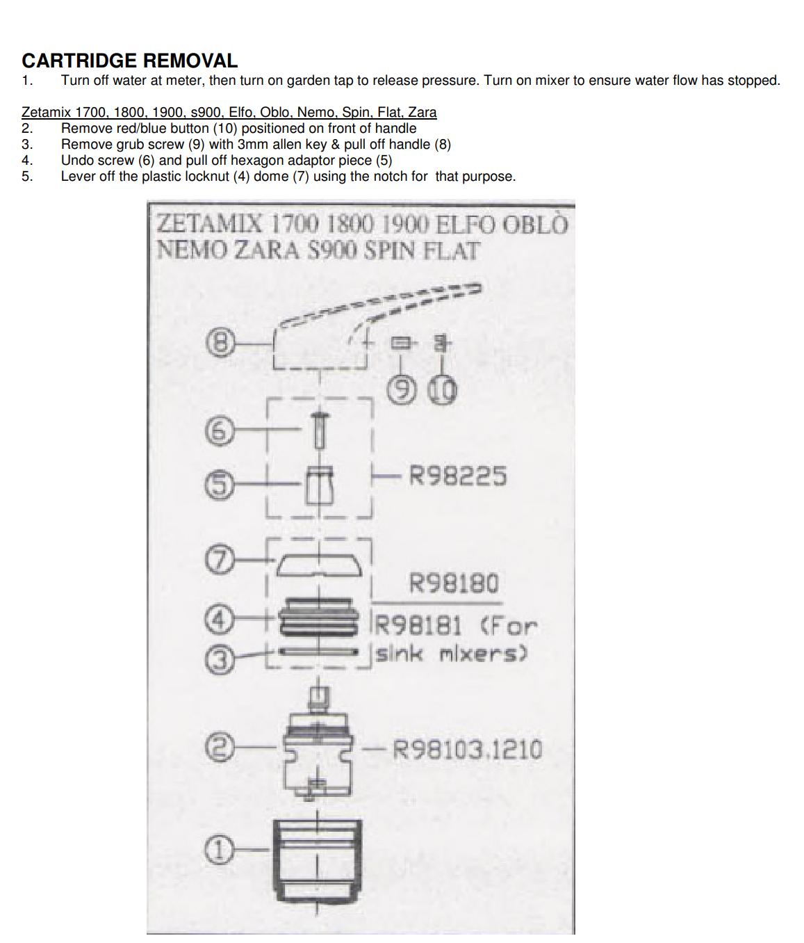

Re: bathroom tap handle stuck
Hi @Xiana,
I just googled Zuccheti mixer tap, and it was the second thing that came up. It is a direct download, so I can't add a link, unfortunately.
This is an edited version of what I found -

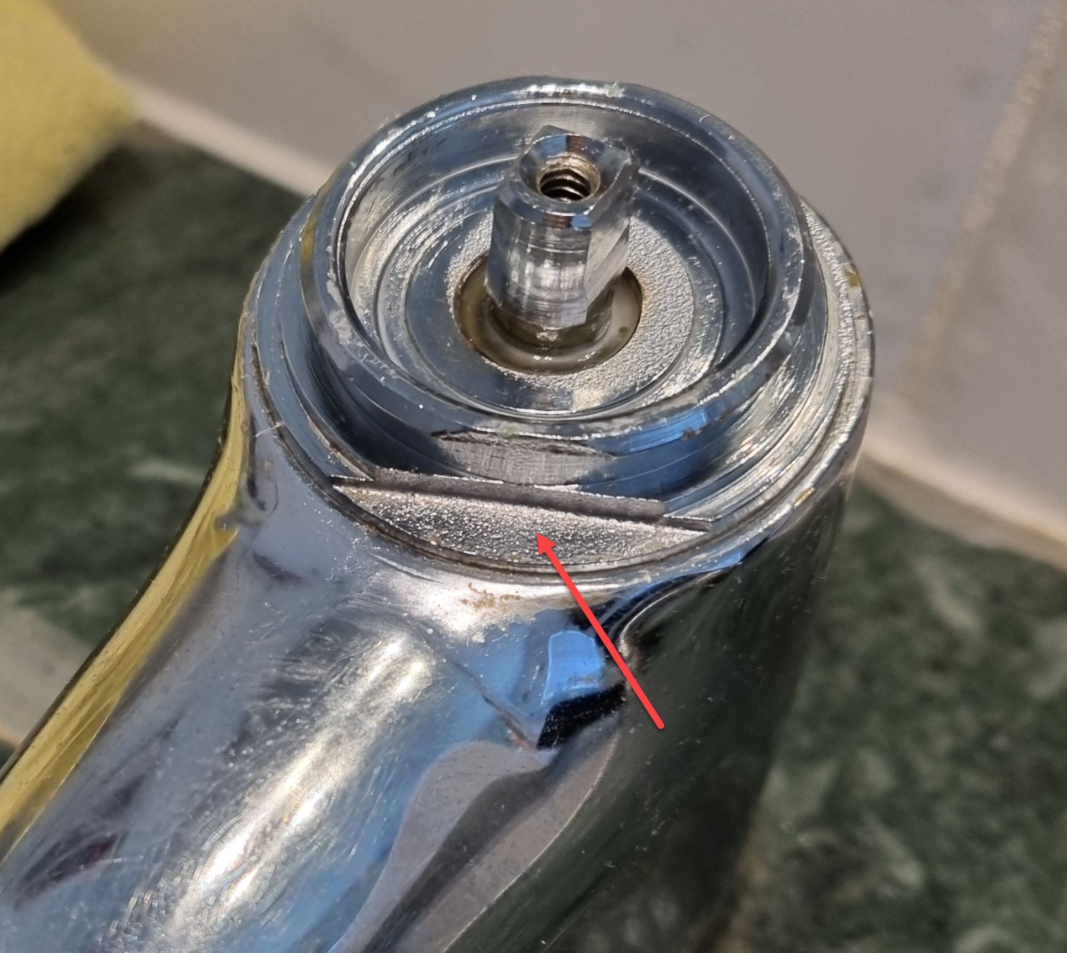

It doesn't look exactly the same, but I'd say the round piece either pops out with a lever, such as a flathead screwdriver or twists out using the flat section I've shown below for grip.
Try grabbing it with some multigrip pliers wrapped in a cloth and twisting it anti-clockwise. If this doesn't work, then try levering it off with a flathead screwdriver.
