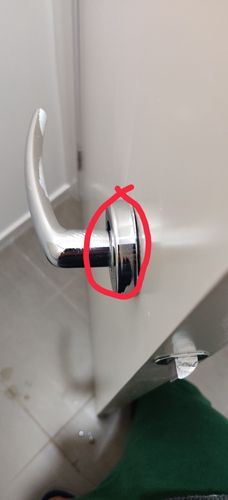

Could someone pls guide how to tight the door handle. Please find the pic below. Door handle is similar from both side of the door. I have other doors as well where handle is loose. Thanks in advance

Typically these would be the steps to follow: gently remove the faceplate from the handle by locating a small hole around the bottom of your faceplate and unlock the plate with an allen key. You will then be able to tighten the screws on both sides of the door. Place the faceplate back onto the handle and lock back in with the allen key.
If you cannot remove the faceplate, please let us know and send us more photos of your handles so we can see what you are working with.

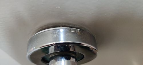

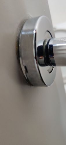

Hi @KatieC thanks for the steps.
Not sure if there is an Allen key to open the faceplate and unable to open the plate with screwdriver. Pls check pics below.

Thank you so much for those additional photos you posted. You'll notice that in one of the photos the faceplate has a slot cut into it. I suggest placing a flathead screwdriver into the slot and levering the cover off. Make sure to do the same thing to the other side so that the cover does not get stuck in place. The cover is basically pushed on and you've got to pull it off. There's every possibility that it is very tight and you may have to do several tries before the cover comes off. But once you have the cover removed all you need to do is tighten the installation screws to get the door handle to firm up on the door.

By the looks of the pic there appears to be a cover plate on the handle which needs to be removed first. Then you can easily tighten the handle and push the cover plate back on.
You need to get a small flat screwdriver behind the cover plate (not the handle) and flick the plate foreward. Carefully do this all the way around until the cover slips off.
