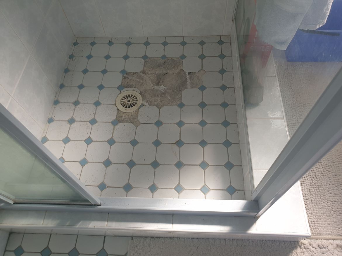

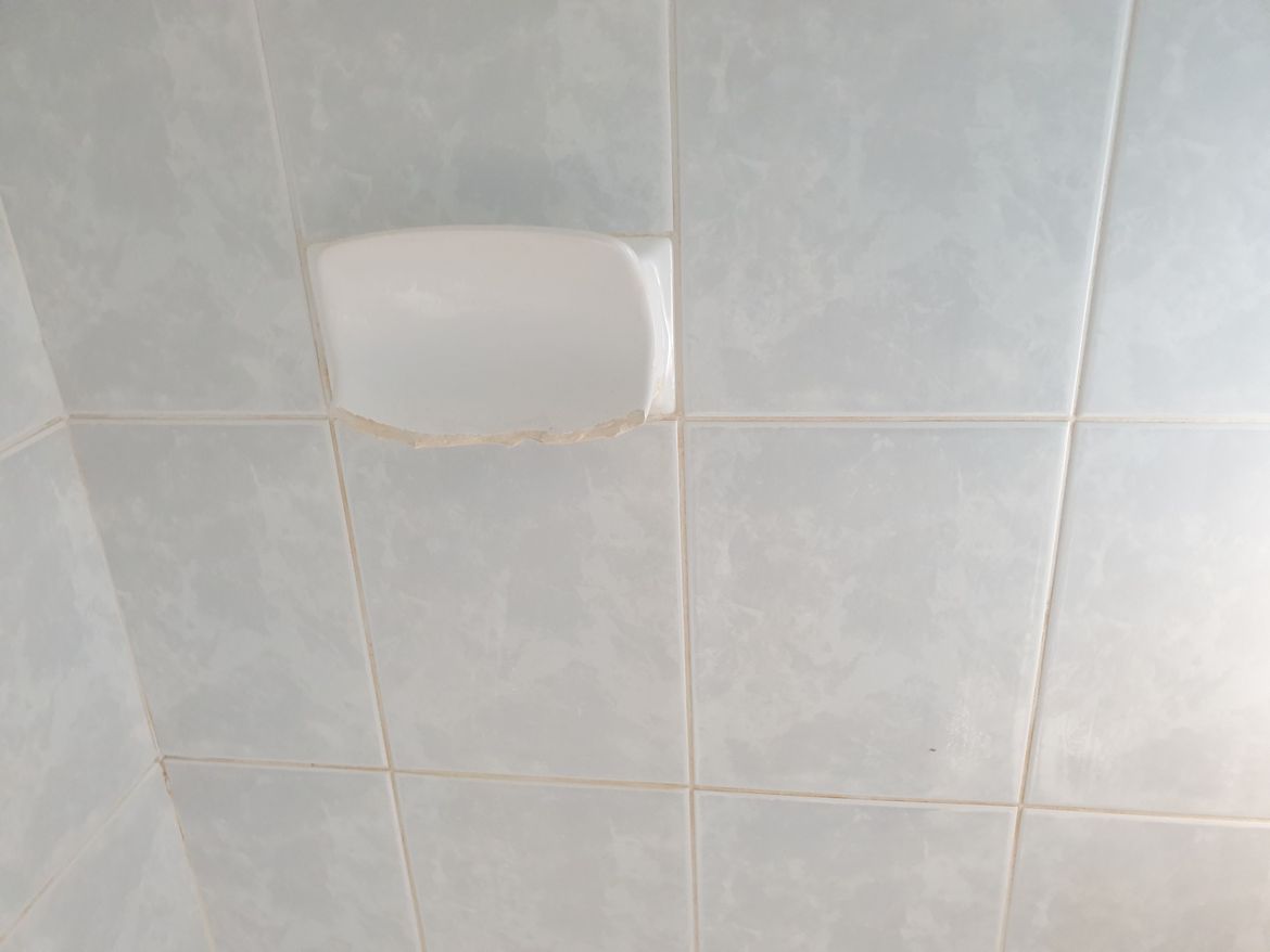

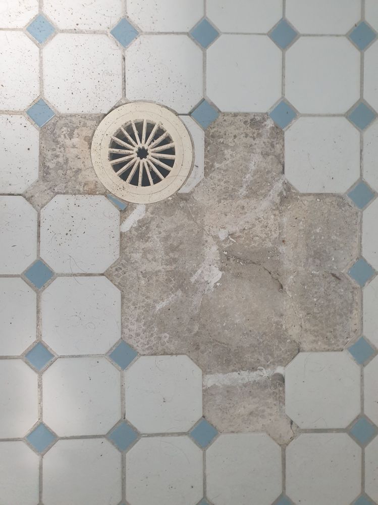

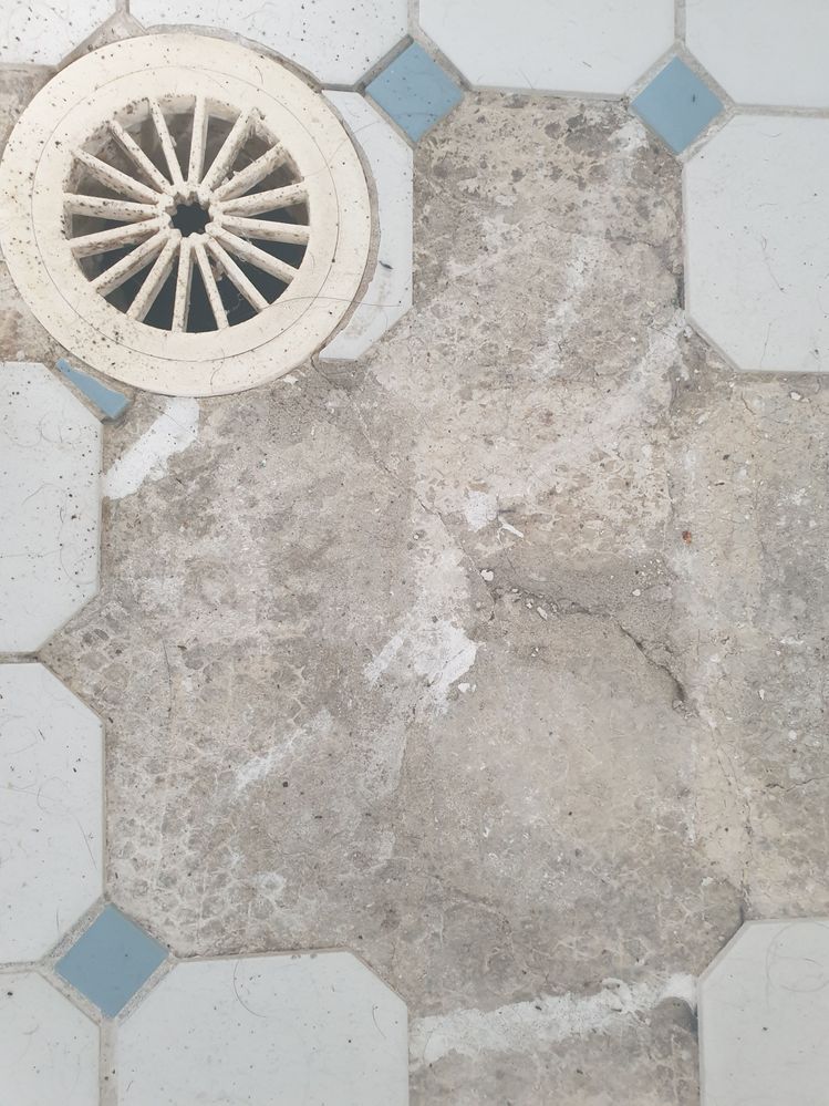

  • shower floor tiles, water leakingshower floor tiles, water leakingsoap holder brokensoap holder brokencrack in floor under tilescrack in floor under tiles
  • Upstairs shower, the tiles have lifted and water leaking
  • House was built 27 years ago
  • I have the tiles, but needs waterproofing, or maybe install a shower base instead
  • Please advice. Thank you

Thank you for providing the photos of your shower enclosure. Based on the images, it is challenging to assess the full extent of the damage to the shower base. Additionally, it is unclear whether a waterproofing membrane was applied during the original installation. Given these uncertainties, I recommend consulting a qualified bathroom renovation specialist to obtain a professional assessment and a quote for a complete shower replacement. I suspect that a patch-up job will not suffice or provide a long-term solution to your showers current condition.

At 27yrs it's high unlikely there was any waterproofing used. That aside, it would be far easier to remove and replace the base with either a tile over shower base or even easier a solid acrylic not requiring any tiles, which would be the way I would go. The soap holder could be replaced.
The walls of the shower can have a full height clear waterproof epoxy applied by a certified waterproofer.

My thoughts definently head towards @Nailbag's suggestions. Instead of paying money to repair it would probarlly be better spent towards either the shower base or a rip out and redo with proper waterproofing.
Depending on the state of the rest of the bathroom. If water has tarveled under the tiles (as the shower shows) then you could be back with other repairs outside the shower itself.
