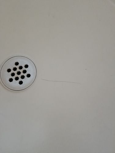

 i noticed my shower base has a hairline crack  in it the house I'm in is about 25 years old how do I fix it
Its ivory colour also
I can't afford to replace it
No water pulls anywhere
Its strong as doesn't move  when you step into it
Is that just general wear and tear?

As the crack does not appear to penetrate through the shower base, it doesn't pose a great risk in terms of failure of the shower base right now, but it is worth noting that this crack could worsen over time, so it is a good idea to keep an eye on it. If things get worse, you may have to look at replacing the shower base.
In the meantime, you can use this Rust-Oleum 13.3ml White Tub And Tile Touch Up Kit, which is a two-part epoxy acrylic solution that can be used for touching up and sealing cracks like this in high moisture environments.
Make sure you have a good read through the product specifications prior to carrying out your repair, especially the surface preparation steps.
Once mixed, you can apply the solution to the crack using a craft brush.
