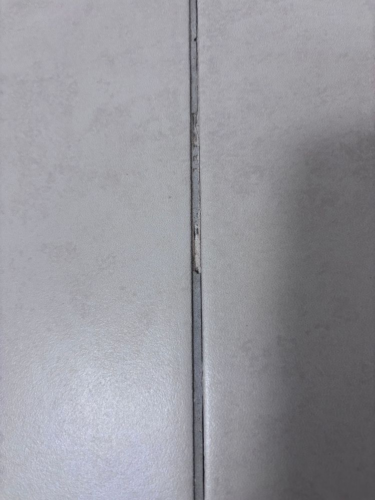

We have got 2 showers, are 7 years old, roughly used by kids. Looks like some maintenance need to be done. Request someone guide me how to proceed on these.
Attaching photos here.
Issues are like
1) Cracked/broken tile grout
2) Also, grout has come off completely at one place (about 10cm length).

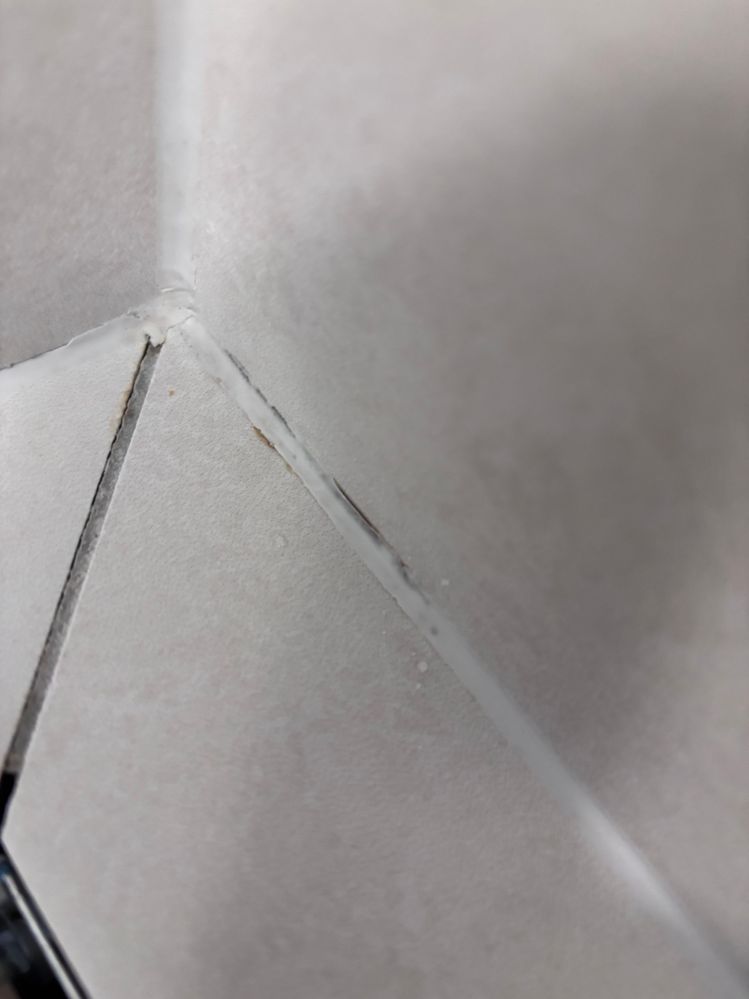

3) And Silicon at corners (where tile meets wall) is coming off too.
About 10cm tile grout has come off
Grout has come off
Silicon has come off at corner
Broken tile grout
Thank you very much for your time.
Hi @ppp,
For cracked or broken grout, carefully remove the damaged grout with a grout removal tool or utility knife, clean the area thoroughly, and then apply fresh grout using a grout float, pressing it firmly into the joints. Wipe off any excess with a damp sponge and allow it to cure according to the manufacturer’s instructions. For sections where grout is completely missing, follow the same process, taking extra care to smooth it so it blends with the surrounding grout.
For silicone that is coming off at the corners, cut away the old silicone with a utility knife or silicone remover tool, clean and dry the area thoroughly, and then apply a new bathroom-grade silicone sealant along the joint, smoothing it with a wet finger or finishing tool. Be sure to wear gloves, ventilate the bathroom, and avoid heavy water use on the repaired areas until the grout and silicone have fully set to ensure a long-lasting repair.
Here are some helpful guides: How to remove grout, How to remove silicone, How to grout tiles and How to apply silicone sealant.
