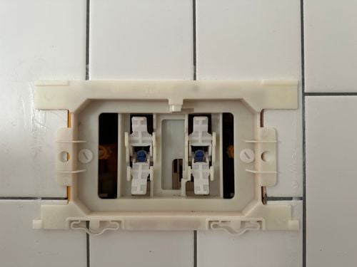

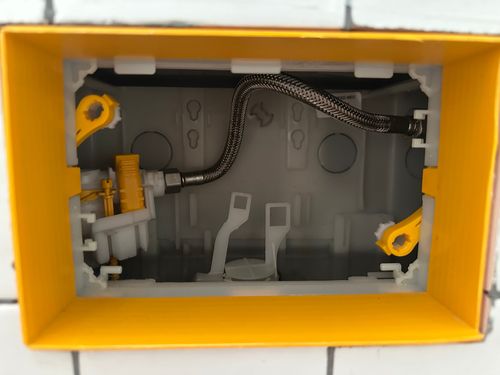

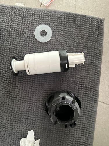

Hi guys. I live in an apartment which comes with Oli Expert Plus concealed cistern. About 10-15 minutes after flushing the toilet, water Would leak into the toilet. I’ve changed the seal washer but the problem persists. Here are some pics:
I’m quite clueless… does anyone have a similar problem or experience what could be happening? Would really appreciate your help.

Few tests to establish problem area. Shut off inlet valve after tank fills up if it leaks now then it is out let seal inside tank. If it stop then the inlet valve doesn’t close upon filling and it is overflowing.

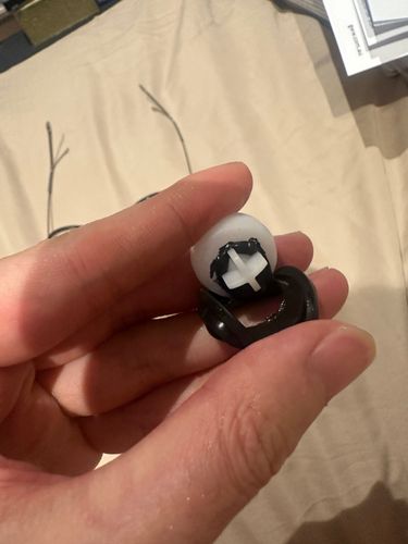

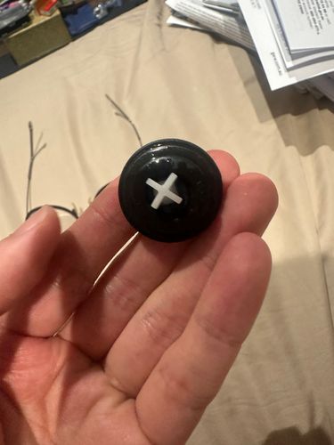

Thank you for your help. Ive identified the problem. The inlet seal thing is broken:
But I'm not sure what It's called and how to get replacement. Can I get it any bunnings? Many Thanks.

Such a small peice but makes a big system fail. It is this
https://www.bunnings.com.au/fix-a-loo-inlet-valve-headseal-washer_p4920371
Unfortunately in my case replacing this didn’t help and I had to replace entire inlet system. I hope it doesn’t happen to you. Good luck

I couldn't find an exact one so I bought a similar one with the same rubber seal, peeled off the seal and put it on the original one. Seems to be fixed now, no leakage so far.
