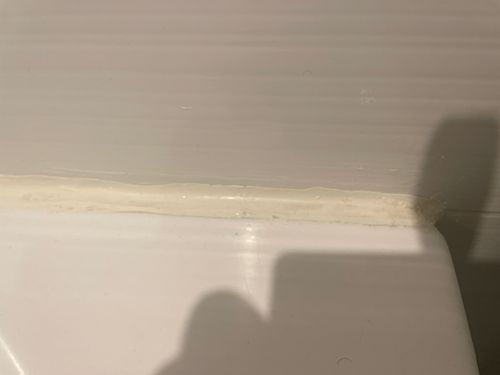

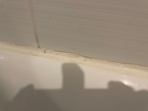

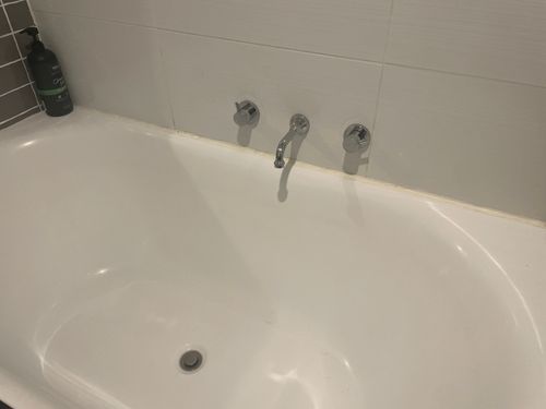

my husband filled this gap that was so big due to the wall nog being straight. What can we do to fix it? It looks so ugly!!

If this is as close as the bath can be pushed to the wall there is not much more that can be done. The gap will remain the same unless the wall is adjusted to take the baths irregular shape. However, you can tidy up the application of the silicone by using masking tape. I propose removing the silicone that is currently on your bath and re-applying it using the guide I've placed below.
Here is a handy step-by-step guide: How To Silicone Seal A Bath
Using the guide, you'll be able to place a uniform finish on the edge of your bath even if the gap is large.
