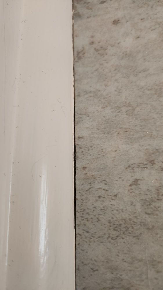

So I'm going to repaint my baseboard to fix a rookie error when painting it the first time.
Since I'm doing that I want to fix another finishing issue. When my lino was replaced they didn't remove the baseboard trim...just took it up to the edge of the trim. On really close inspection (which I've been doing a lot) there is a gap of about 1mm (yes it's tiny) on some sections between the timber trim and the lino. It doesn't sound like much but when you're painting the trim a light colour I notice it. Is there something I can do about this to make it look more nicely finished? Whatever solution I'd apply to all the baseboards for consistency. Keep in mind I'm re-applying the paint job so ruining the current paint job isn't a concern.

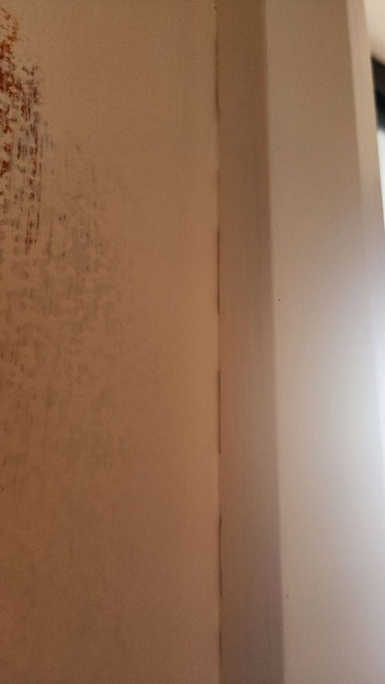

I have a similar issue around the window frame trim and the wall (wall yet to be painted). Some evidence of tiny gaps between the frame and wall that aren't filled with paint when trim is painted. Again, possibly an application of a paintable gap filler required?

Photo examples attached. Wall to window trim
Trim to linoleum on floor

Thanks for sharing your question about fixing the gap between your trim and lino. There are three possible options you can explore.
First is to use a gap filler on the trim and lino. Gap fillers often dry flexible so there is room for it to move. I recommend using Selleys 475g No More Gaps Interior Multipurpose Gap Filler. I suggest using the same product for the gaps in your window area.
Second is to install another trim on top of your existing trim such as the Porta 9 x 9mm 3.0m Moulding Tasmanian Oak Quad Select. You'll need to glue it and then nail it in place so that it won't move.
The third recommendation is to remove your existing trim and replace it with a larger one so that it goes over the new lino.
