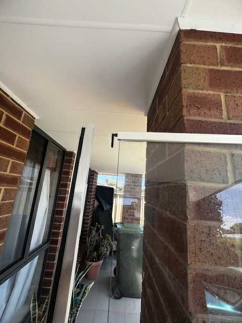

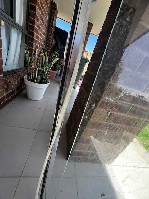

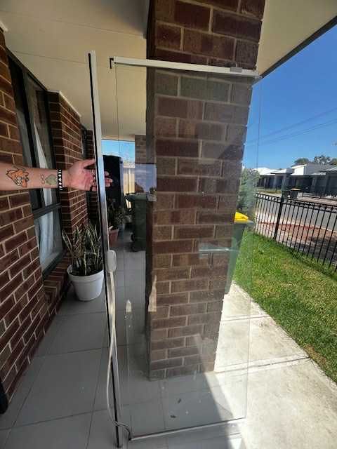

who do i get out to fix this or how can i fix it its my shower door and the sides have fallen off so have taken the whole door off to prevent it breaking more of the shower or smashing so wanting to fix it

If you can take a photo of the top and bottom of the vertical framing member, aiming in towards where it connects to the horizontal framing member, this would help identify what has happened and potentially lead us towards the solution.
