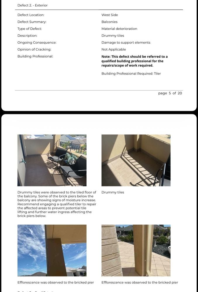

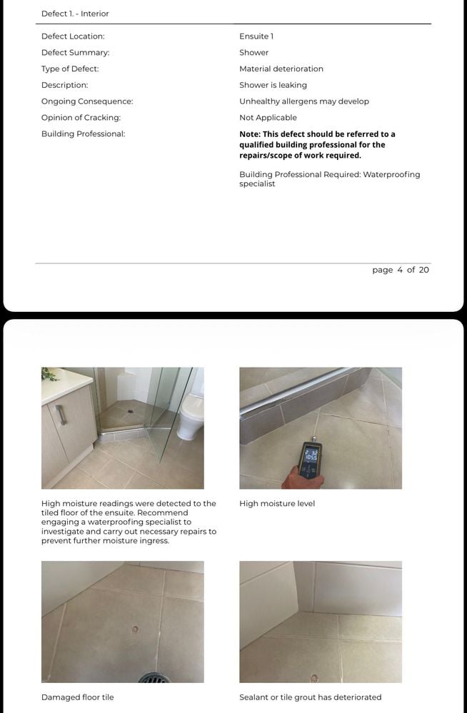

Building inspector on a pre-purchase inspection reported as attached and advised this is normal for a house over 10 years old and nothing to stress about or of any immediate concern.
I am thinking I rather sort this out now but I do not understand the scope of work or cost estimates from best to worse case scenario.
What am I looking at? What should I do? and please give me rough cost estimates for best and worst scenarios.
I am in WA.
